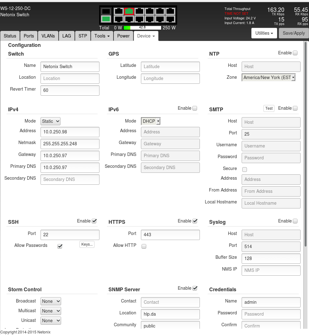

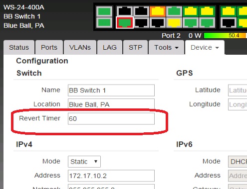

On the Device/Configuration Tab there is an input field called "Revert Timer" and the default is 60 seconds. What this feature does is prevent you from making a mistake to a remote switch that causes you to lose control and have to go driving to recover your mistake.
When you make the change you are referring to the Web UI that you are using to configure the switch is losing access to the switch due to your VLAN changes and is unable to re-connect to the switch within 60 seconds so the switch is doing exactly what it should and revert back to the last configuration.
If you do not want this feature you can disable it by changing the value to "0" but obviously your changes are causing you to not be able to reach the switch so you will lose control.
Or you can increase the value to say 300 which is 5 minutes before it will revert.

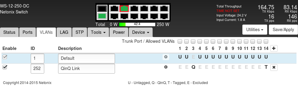

My config is simple. I have two VLANs, the default management VLAN (1), und another one (252).
Vlan 1 is untagged on all ports exept port 3. Vlan 252 is untagged on port 3 and tagged on port 13. This works fine.
Then I change port 3 to "Q" mode and immediately loose access. Am I doing something wrong?

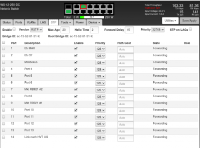

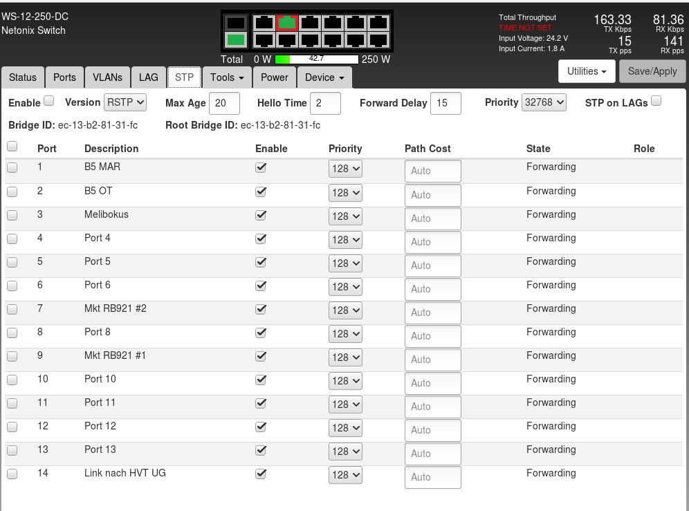

Here you go. This is the working config before the changes:

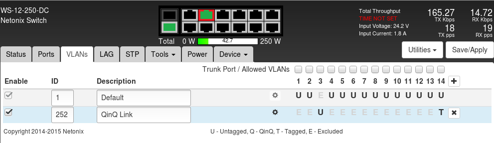

And this is before saving changes:
