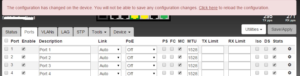

I keep getting this error after a few seconds of clicking where is says click here to reload.. Help! :)

What version is running on the switch? Make sure you're on current firmware or even the latest RC.
What browser? have you tried it with another browser? Are you sure no one else is in the switch?

I've seen the same error under both Firefox and IE (Windows 7)... I've also found that I'm able to save the changes anyway. In most cases where I've seen this I'm pretty sure nobody else is in it because it is sitting on my desk and the only thing connected to it is my laptop.
If I see it again (and remember to) I'll gather more info to share.

Can also happen if 2 devices/switches are on the same IP and your laptop probably has a wireless connection.
