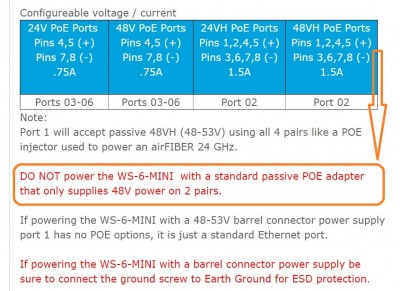

Is this POE adapter supping power on all 4 pair or just 2 pair? You say airMAX which means 2 pair power not 4 pair power like the AF24 adapter.
Try using a recommended POE adapter like the AF24 POE adapter that supplies 1.2A on all 4 pair.
You can not use a standard POE adapter that only supplies power on 2 pair and expect it to get enough amperage. You may have damaged the switch trying to use a stadard POE adapter.

Sorry, my mistake. Wrong wordings. The power adapters supplying the 48V to the mini's are the ones usually used for the Airfibre units. Not airmax.
I read the spec sticker now and indeed it says +(1,2),(4,5) pins. -(7,8),(3,6) pins.
It was recommended to use these....

Oh yeah, it also reads 50V 1,2amps...
