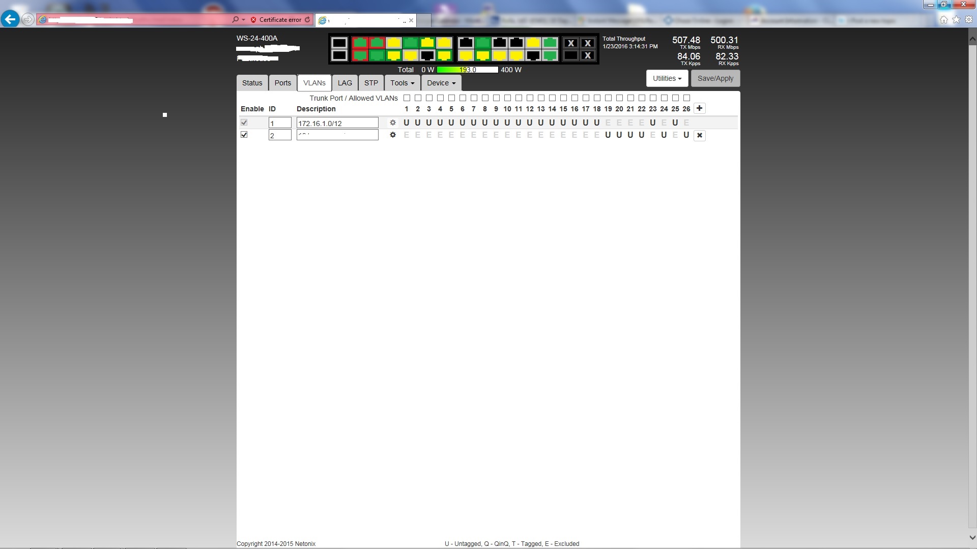

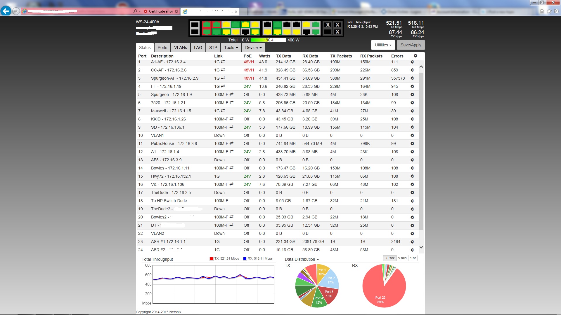

I have an ongoing issue which seems to be coming more prevalent where all traffic ceases and my WS-24-400A becomes inaccessible on only one VLAN (VLAN1) for an undefined period of time. This could last for just a few minutes or up to an hour. Interestingly, my second VLAN (VLAN2) still functions correctly during this "outage" and the switch is accessible on it. My setup is pretty plain (see screen shots). I have 2 Cisco SFP modules in ports 25-26, which are not in use. The errors appear during the outage. Nothing looks out of ordinary in the log files, but I am yet to examine them closely when the outage occurs.

You do realize that the switch UI/CLI only responds to the Default/Management VLAN which you have chose to leave as VLAN ID 1.
VLAN 1 and VLAN 2 do not talk to each other.
Basically you divided the switch into to logical and separate switches.
If you did assign a "non-rout able" IP to VLAN 2 which that function is primarily for allowing the switch to directly ping devices without having to rely on a router for watchdog.

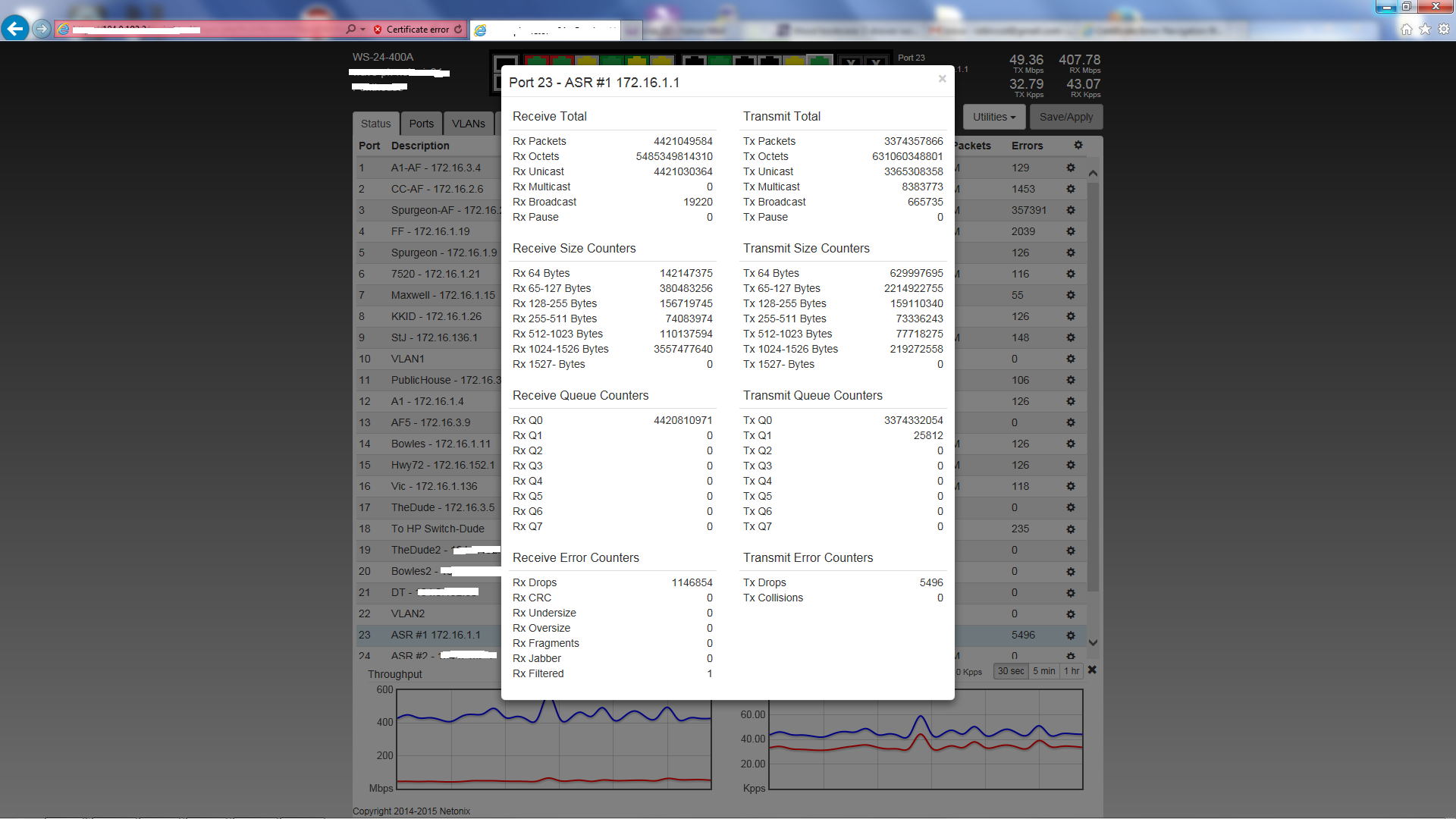

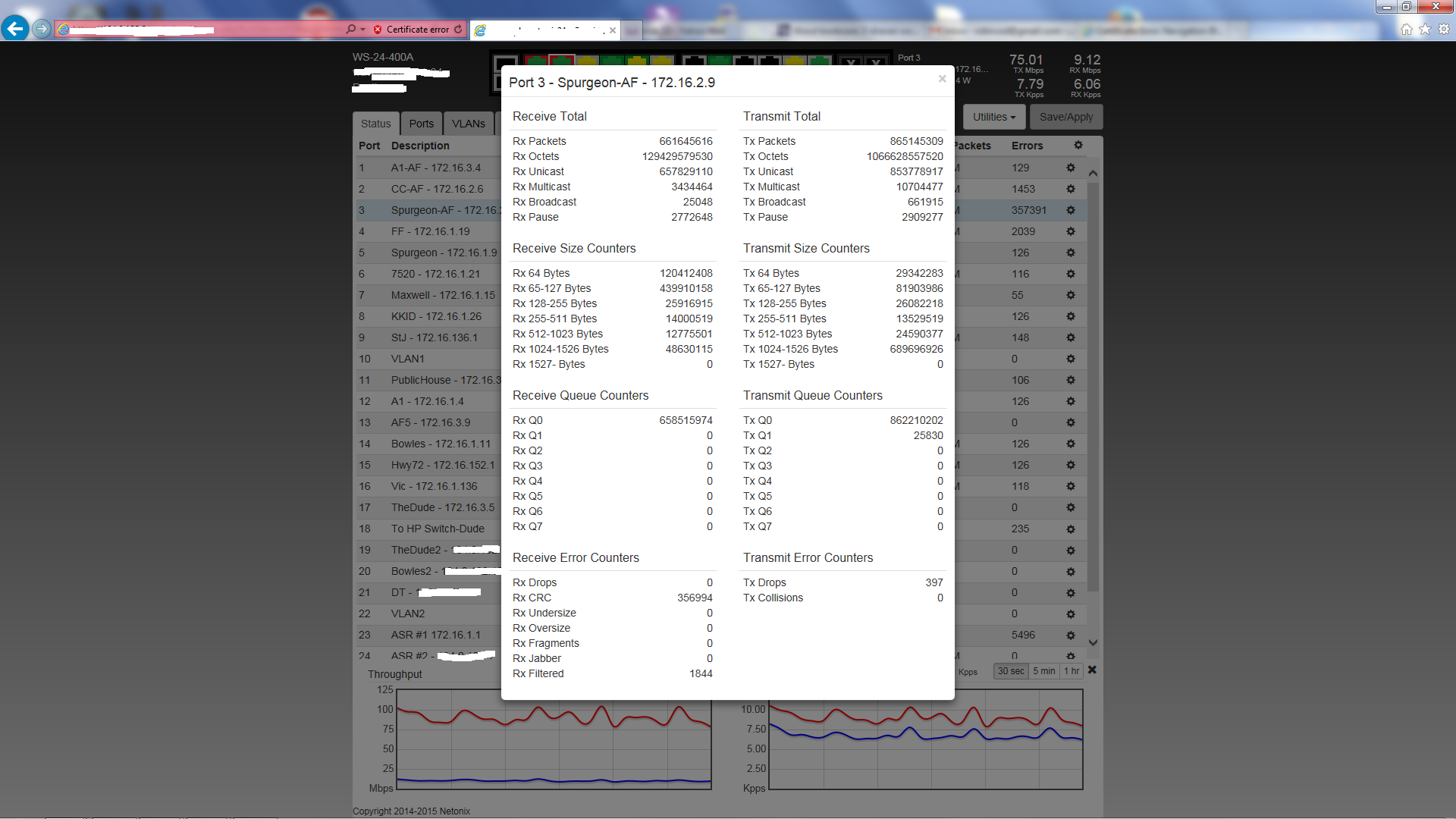

Also look at the port details on all the interfaces that have these errors, what type of errors are they?

I have attached screen shots of two of the ports. Port23 connects to the Cisco ASR1002 and port 3 powers an AF-24HD. The AF-24HD has ping watchdog enabled and reboots itself during the outage. Any thoughts?
