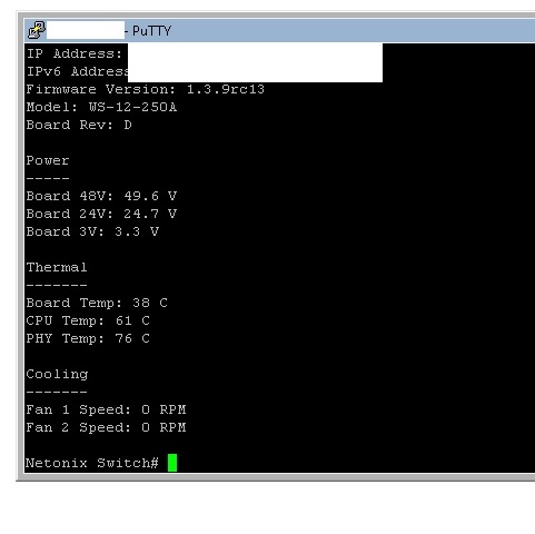

Also today i again lost access to the web ui while trying to look at the MAC table.
I was able to ssh in and show status gave me this.
A reboot fixed the fans and temps I wasnt able to get the log file before a reboot but after the reboot the log file seems strange to me.
what should the phy temp be around anyway?
Since I started writing this I have been kicked out of the web ui 2 more times
the switch doesn't seem to stop passing traffic when this happens my pings stay consistent.
I have noticed seeing either or both of these when this happens
Jan 31 09:05:55 monitor: restarting vtss_appl
Dec 31 16:01:46 system: starting ntpclient
Thanks, Travis.
