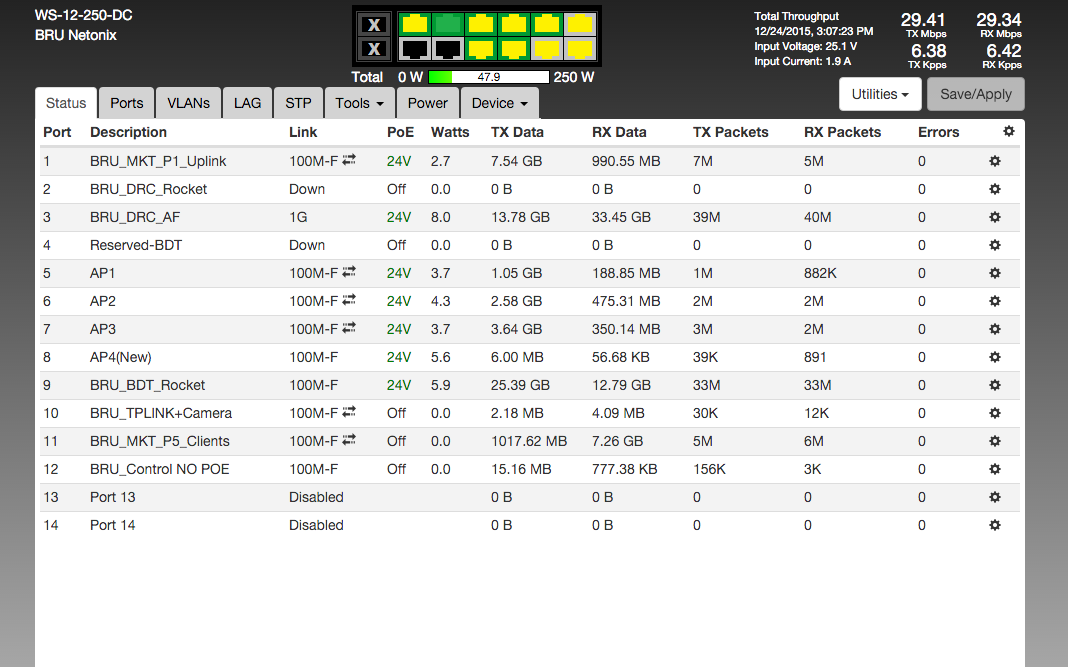

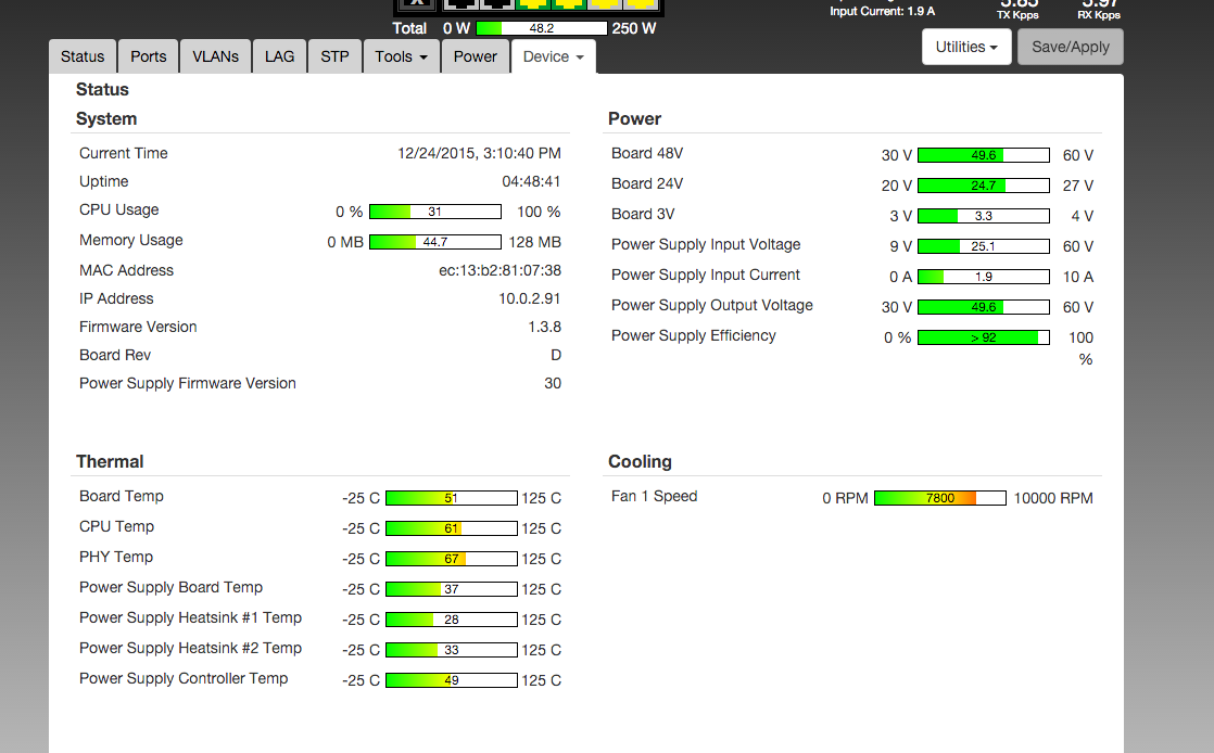

We are experiencing really strange things with this switch, errors saying fan failure (but it is not failing), error reading temp sensor, then the switch performs a cold reboot.
System has 150ah of battery connected
Firmware 1.3.8
Here is the log, attached are screen shots. Switch is in a VERY remote location
Any ideas?

Yea we are investigating possible FM broadcast towers messing with the DC Switch models, mainly the I2C communications between the DC power supply and the switch board.
There is some enhancements in v1.3.8rc8 to the I2C error handling, please try this version and see if it helps and let us know.
We also are working on a shielded I2C cable which I could also send you after the New Years if the software does not help you.
None of our AC switches are affected by FM Broadcast towers, just the WS-8-250-DC and WS-12-250-DC
