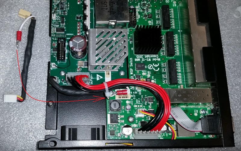

We are also working with a couple people who are on HEAVY AM/FM/TV broadcast towers that are trying an experimental shielded I2C cable between the switch board and the DC2DC power supply. see picture below
Notice the white ground/shield wire that connects to the chassis via the switchboard screw, but for this to work the user MUST have the chassis grounded to earth ground via the earth ground screw on the front of the chassis since this is a DC switch the switch NEEDS an earth ground which should also be bonded to the tower ground system. If the switch does not have an earth ground then the ESD shielding on the Ethernet is useless.
