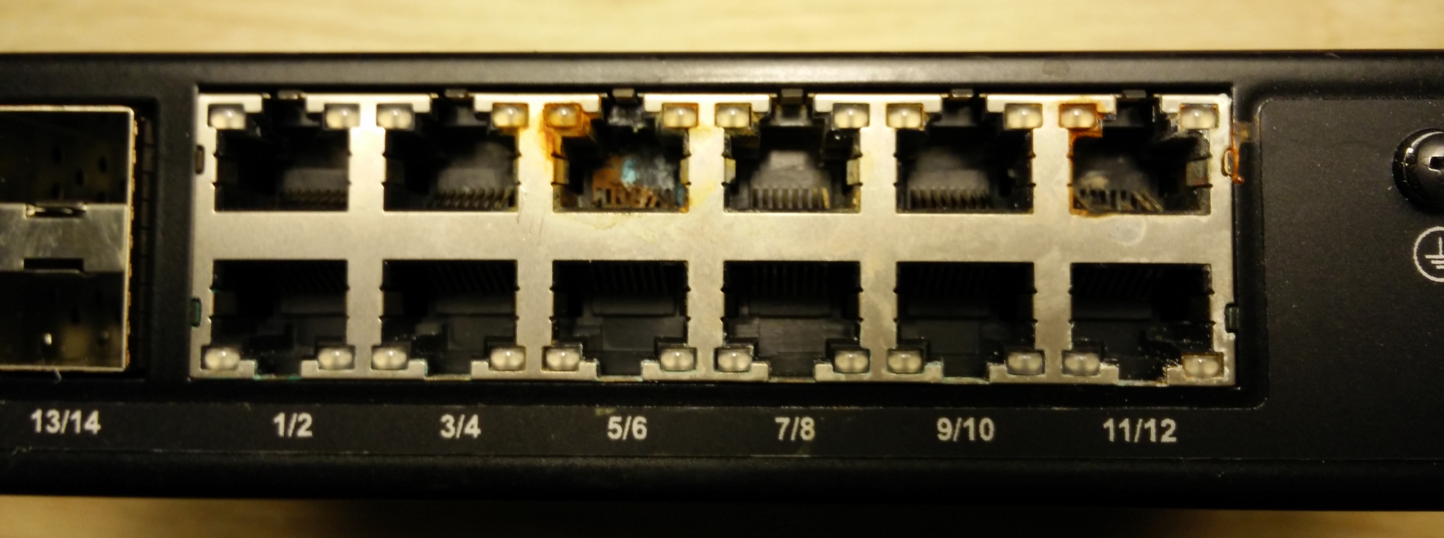

Bad cable with water in fried the port
Posted: Sun Dec 20, 2015 7:43 am
by jjonsson
I had a bad cable with water coming in and it fried the port. I have tested the switch and it seems to work fine (Don't know about the fried port).
Can I get spare parts ?
Re: Bad cable with water in fried the port
Posted: Sun Dec 20, 2015 6:14 pm
by Mikea
The best solution is to get a quote for repair since the oxidation has infected ports 5,7,11.
I wouldnt provide any POE over those ports since (if not repaired properly and not only change the infected Ports) can do more damage on the switch components.
