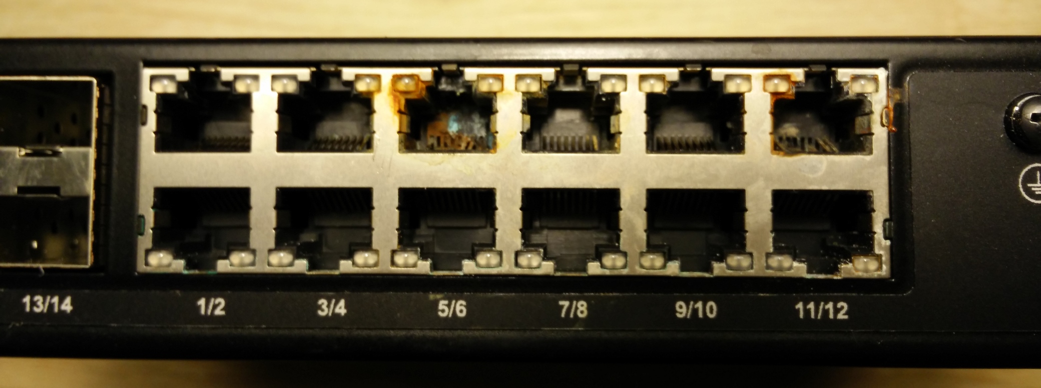

I had a bad cable with water coming in and it fried the port. I have tested the switch and it seems to work fine (Don't know about the fried port).
Can I get spare parts ?

The best solution is to get a quote for repair since the oxidation has infected ports 5,7,11.
I wouldnt provide any POE over those ports since (if not repaired properly and not only change the infected Ports) can do more damage on the switch components.
