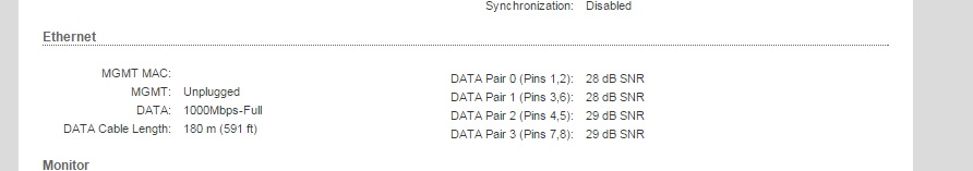

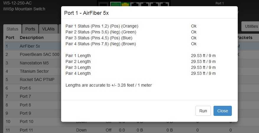

Someone who can tell me what's going on here ?
I run cable test, everything looks fine
AF-5X data 02.png (8.73 KiB) Viewed 11386 times
Hm.... No link ?
AF-5X data 01.png (4.5 KiB) Viewed 11386 times
And that's before and after cable test ?

From what i can tell seems there is some issue with AF5x (FW v3.2) cable testing-sensing cause in my case i have the following wrong lenght calculation in AF5x:
1st screen from AF5x
2nd screen from Netonix switch AF5x is connected to

I'm doing cable test from the switch with the AF-5X powered on. Since the radio is powered on, I have contact to it through the link, not the data port, as it as shown says no link....
I just don't get that the switch reports everything good, when it's not ?!?!
Ok, testing several times reveals different results, so I expect the connector at the AF-5X end to be bad. I have turned it off now, so that OSPF routes the traffic correct.
