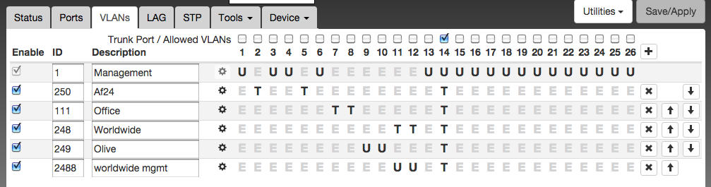

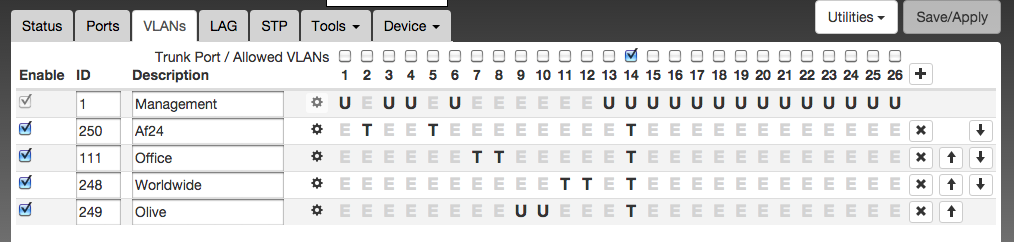

Setup a 24 port unit last night and using it as a mid-span for the time being. I am tagging at the router and untagging at the tower as you can see from my VLAN config in the image below.
Only issue I am trying to overcome now, is access to the management IP's of the point to point links I am using on the switch.
Should I add another untagged label to each respective tagged port?
Thanks in advance

Answered my own question by giving it a try on the worldwide link. I added an untagged marks to the same ports with an arbitrary tag number and was able to access the management IP's.
Is this the ideal way of accomplishing this? Any alternate options?
