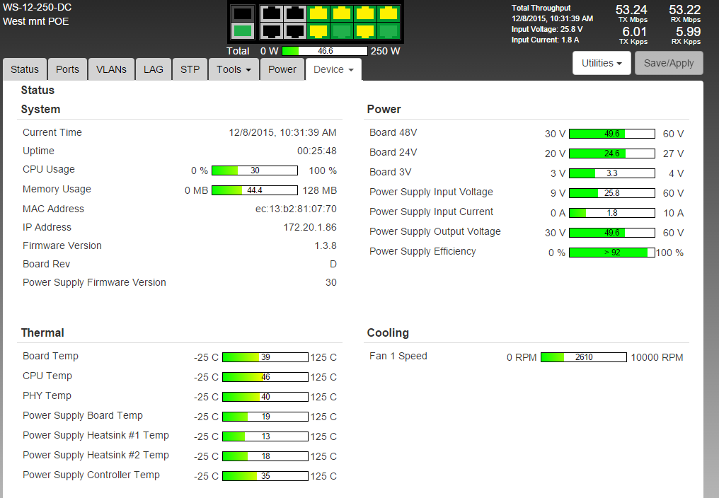

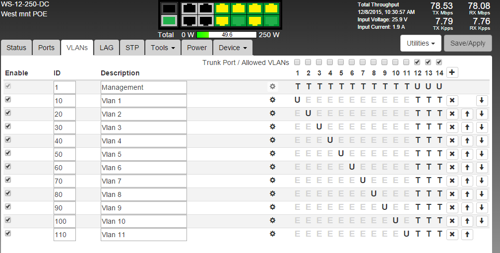

here is the status and Vlan page right after I had to power cycle the unit. I have one other switch so i am going to try that one out to see if it is just a bad switch.
I make the management available from every connection. This way if a link is down I can access the POE from another link. It would not respond on any port.

The only ports the UI would respond to with untagged traffic is ports 12,13,14 and of course there is nothing in port 13 so 12,14
If you try to access the other active port 5-11 you traffic destined to the UI would need to be tagged or the packets would be dropped.
Its hard to envision your network topography as your port descriptions lack hints as to what they are such as Back-haul, AP, Router, and so on.
Would be nice to understand what the topography at this site is.
And as I said the most valuable thing here would be the log.

I tried every port even the untagged ones..
