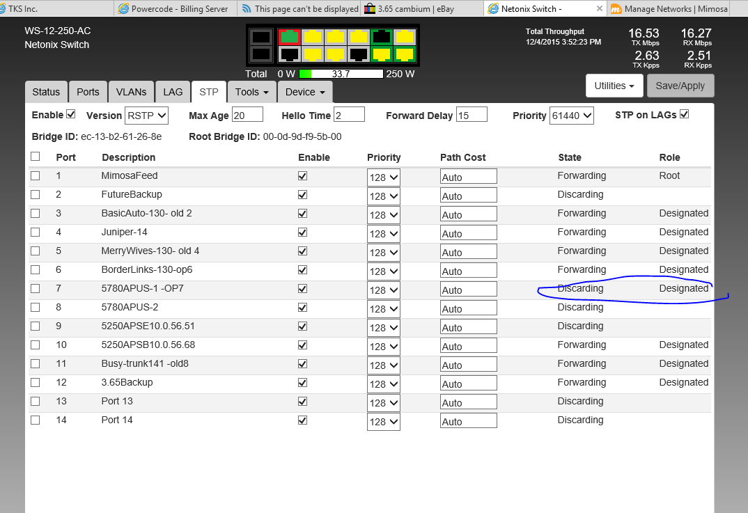

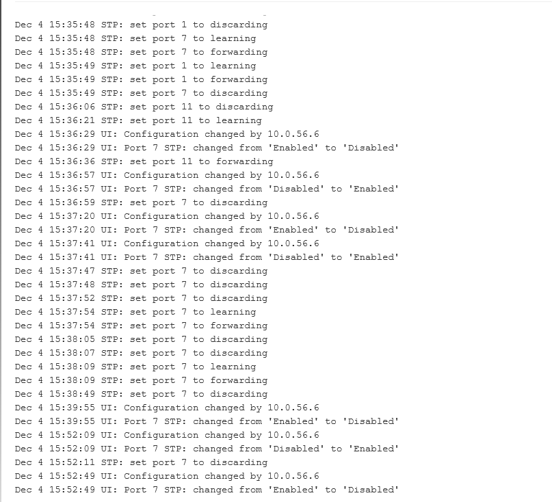

log file showing going back to blocked mode
430 stp blocking log.PNG (54.13 KiB) Viewed 12386 times
showing blocked port
430 stp blocking.PNG (70.66 KiB) Viewed 12387 times
lost connectivity to one 430ap, when I shut off stp on that port, i regain connectivity, when I enable I lose it.
