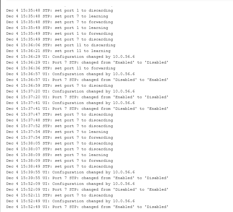

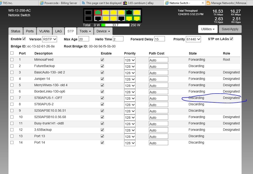

lost connectivity to one 430ap, when I shut off stp on that port, i regain connectivity, when I enable I lose it.
Re: Spanning tree blocking port
If you use wireless link, make sure you have WDS enabled else it can happen.
