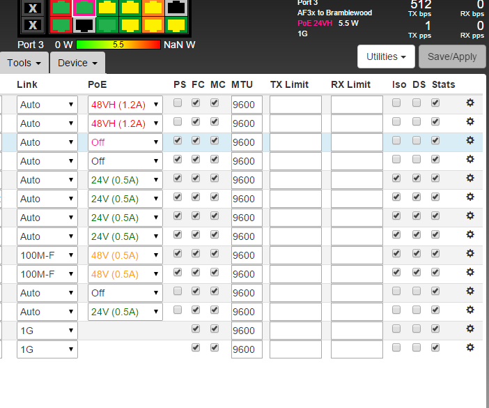

We were trying this morning to configure a port (port 3) to power an Airfiber 3X. There was not a device connected to the port at the start. In the POE drop-menu, only 24V .75A, 48V, .75A, 48HV 1.2A appeared there. Later this afternoon we went back to install the 3x, and from our Iphone (safari) 24HV was suddenly available. We chose it, then it disappeared until we refreshed the entire page. We ended up choosing it a couple of more times, then suddenly it stuck and powered the device correctly.
About an hour later, pulling up the switch from my office (chrome Windows 10), I see the following:
I think you can see the weirdness. Port 3 IS powering an Airfiber 3x, check the status at the top, as the port is selected currently. Notice in the drop menu for POE it is Purple but "Off".
Any insights here?
24VH appearing then disappearing from menu

sirhc wrote:The WS-12-250A does NOT support 24VH, never did.
Chris, than how do you explain this?

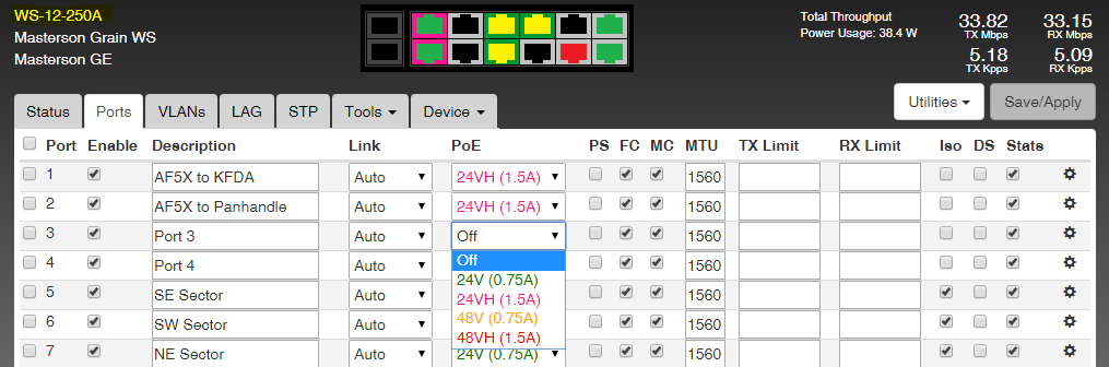

This is in google chrome.
It's showed up like this since day 1 probably 3-4 months ago. I have over a dozen WS-12-250A's running and this is the only one that shows up like this.

This switch was setup from scratch. I only ever use Chrome. Even on my ipad, I use chrome.
I just logged in from internet explorer (ick) and it's showing the same way in it.
here are the switch details.
