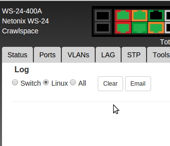

I upgraded a MINI to rc4. The linux log bug I reported earlier is still there.

lligetfa wrote:Who'da thunk it would be under stable? Not me.
Same thing with the WS-24
