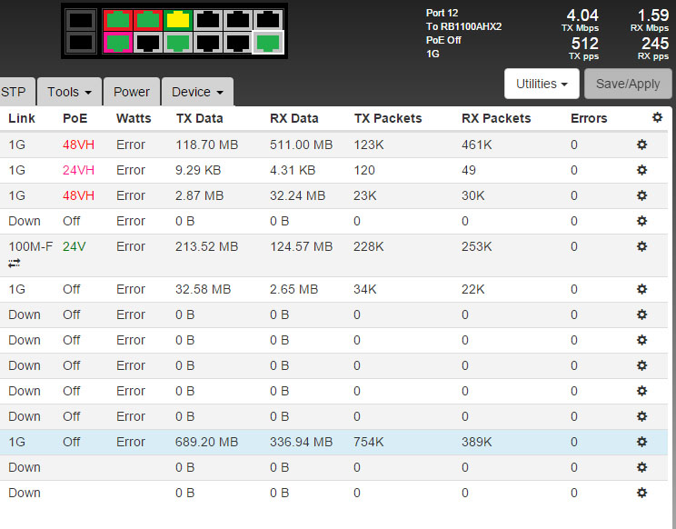

Programming a new WS-12-250DC and I am Receiving the following errors in the log and I am no longer getting a reading in the 'watts' section. It just says 'error'
Any ideas?

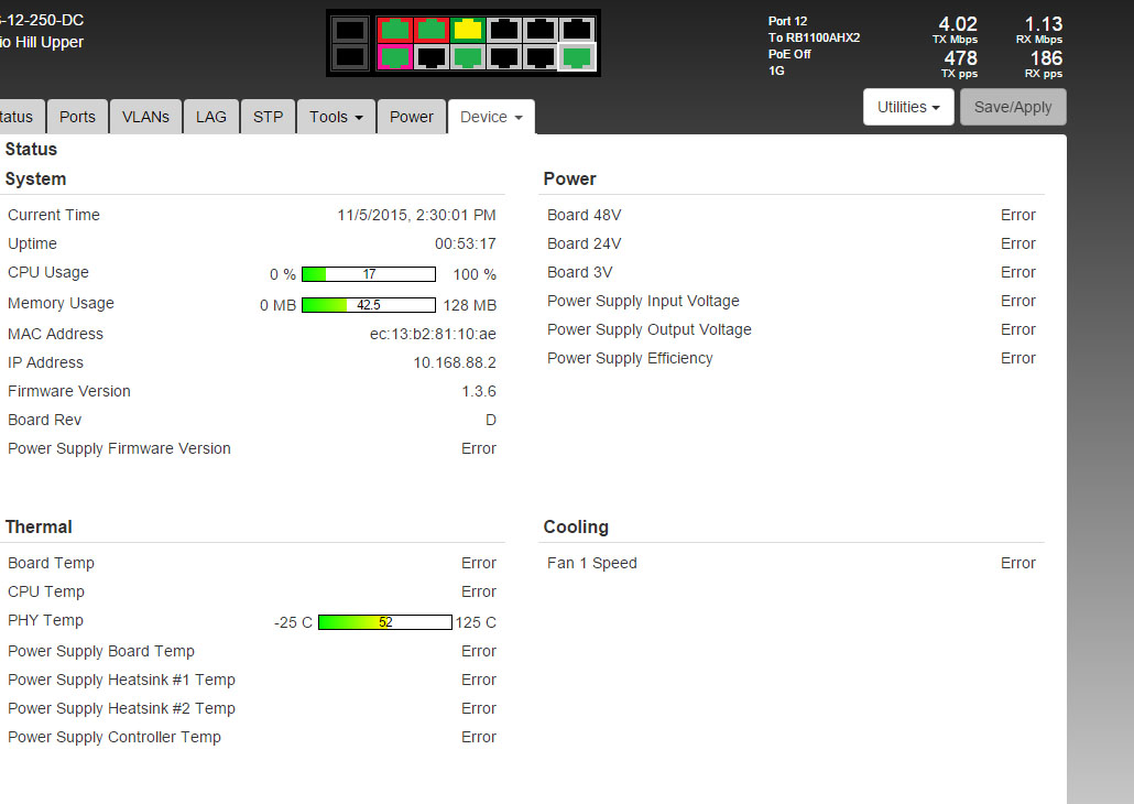

Nov 5 14:14:16 switch[782]: Error communicating with power supply
Nov 5 14:14:17 switch[782]: i2c error: excessive arbitration lost start errors (0x51)
A reboot of the switch made it go away but now it's back after about 40 minutes.
New switch out of the box and updated to 1.3.6
- Attachments
- 2.jpg (136.77 KiB) Viewed 20425 times
- netonix.jpg (135.21 KiB) Viewed 20425 times
Re: Error communicating with power supply
If it's working other than that then I would wait.
It is a bug in the v1.3.5 and v1.3.6 firmware.
I just put up v1.3.7rc7 that has that fixed.
Can you try that and see if it fixes your issue?

The 2nd switch just did the same thing after running fine for almost 2 hours. Is it ok to leave it? I am still up here and want to head home haha. Seems to be running fine though.
Upgraded to 1.3.7rc and the error continues. I am going to power cycle the switch now
I have two 250DC's i just installed here. The 1st one is running fine.
24v power, about ~130 watts use on each one

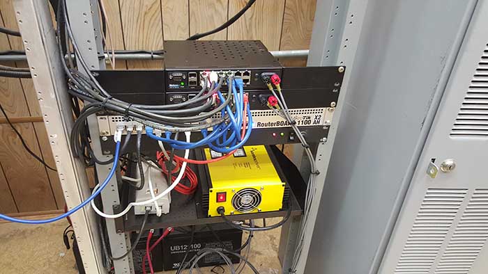

Here's a quick pic....

Also you should space those apart in the rack as you are covering the holes in top of chassis where heat escapes
Good idea. I'll do that now... It's an air conditioned room at 72 but the cooler the better!
