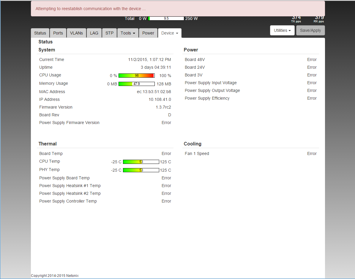

I've got 2 units that are doing this now. I get the following error and can no longer read voltages or temperature via snmp or the main web page, but all other functions seem to be working.
Nov 2 13:07:47 switch[1358]: i2c error: excessive arbitration lost start errors (0x51)
Nov 2 13:07:58 switch[1358]: retrying i2c
Nov 2 13:07:58 switch[1358]: i2c error: excessive arbitration lost start errors (0x51)
Nov 2 13:08:09 switch[1358]: retrying i2c
They repeat about every second. Currently running 1.3.7rc2. Also noticed the CPU's on these 2 units is nearly 100%.

Release notes wrote: NOTE:
Our switches are designed to continue to run even when they are damaged. Sometimes the switch can take damage to sensors from a surge from the tower or ground potential shift between the tower and the cabinet damaging the current sensor on a port. Since all the current, voltage, and temp sensors share the same I2C bus this can cause other sensors to report erroneous values. Prior to v1.3.5 we did not do as good of job at alerting the user to out of range readings, therefore after upgrading to v1.3.5 or newer if you are now seeing voltages, watts, or temperatures out of range this may be an indication that your unit took damage in the past and you were unaware of it. This is why I say to always make sure your Tower Ground is Bonded to your Electrical Service ground and to run a ground wire up the tower and to each radios on the tower. I have a good post HERE about proper grounding methods.Another possible cause of "false" out of range readings can be from an incompatible SFP module. Since the SFP cages also share this same I2C bus to relay information about the SFP module to the system some incompatible SFP modules "can" disrupt normal I2C communication. Try removing the SFP module and see if the readings return to acceptable ranges. If you find an SFP module that is causing issue try another brand of SFP module. We are working on a way to eliminate this interference from some SFP module manufacturers and may offer a firmware in the future to fix this issue with these modules.
With that being said we are working on v1.3.7 firmware which will hopefully deal better with possibly damaged boards?
Not saying these are damaged just possible?
I would try power cycling the units to see if the issue goes away first, let us know. Note, when I say power cycle I mean power cycle not a warm software reboot, although you could try a reboot first but a power cycle is needed.
I have seen this happen on boards that are not damaged and a power cycle resolved the issue. This is one thing we are working on for v1.3.7
We will be releasing v1.3.7 soon, until then you may wish to downgrade to v1.3.3 until then?

New firmware didn't help. Both of these units are atop hard to reach mountain sites so a hard reboot won't be for a while. I'll admit we probably damaged both of these now that you mention it. One of my idiot techs tried to power a 24v reversed polarity canopy module off a 48 volt powered port and the unit shut down until he power cycled it. The other unit we swapped an 8 port for a 12 porter and another idiot tech couldn't figure out how to match port 1 with port 1, 2 to 2, 3 to 3..etc.
