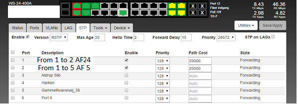

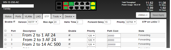

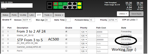

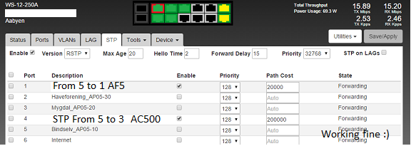

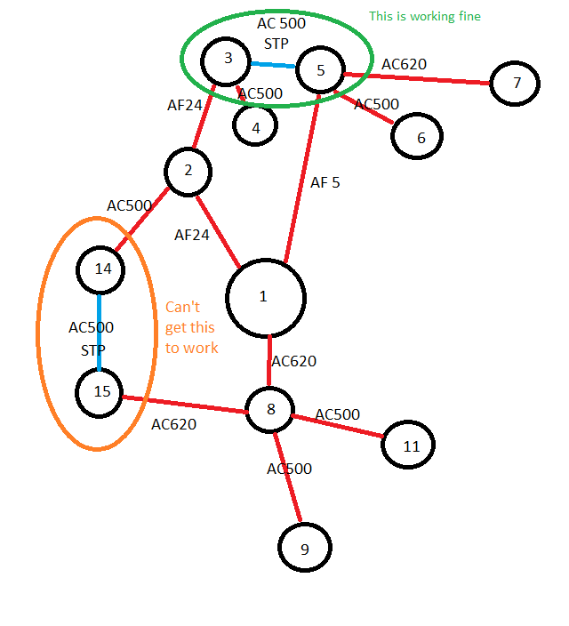

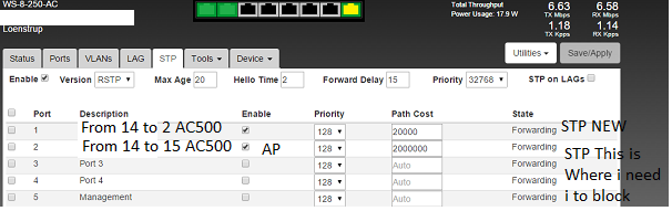

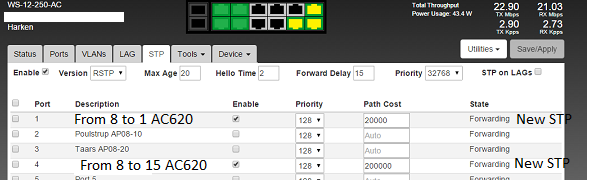

I trying to put op, one more STP on my network, but can not get it to work, hoping that some one can help me.
have made some pictures on have and where in the network i need it to work.
The fiber enters by tower 1.
Plz tell if you need more info. :)
Morten

Help whit a new STP
- Attachments
- Nr 8
- Harken.png (47.42 KiB) Viewed 12411 times
- Nr 5
- Aabyen.png (58.82 KiB) Viewed 12411 times
- Nr 3
- Horne.png (58.88 KiB) Viewed 12411 times
- Nr 2
- Tornby.png (43.38 KiB) Viewed 12411 times
- Nr 1
- Hjoerring.png (58.81 KiB) Viewed 12411 times

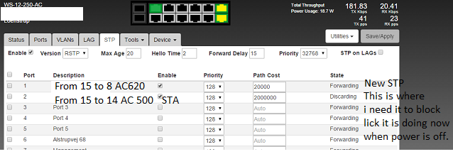

these are the two towers where i need STP to work
- Attachments
- Map.png (24.75 KiB) Viewed 12410 times
- Nr 15
- Loenstrup Silo.png (53.57 KiB) Viewed 12410 times
- Nr 14
- Loenstrup skorsten.png (47.62 KiB) Viewed 12410 times

Re: Help whit a new STP
Hi Mola,
If this in one large flat network this application would be more suited to MSTP not STP/RSTP.
Currently we do not have MSTP implemented, it is slated for a future release, not sure when yet.
Also you should upgrade to the latest firmware HOWEVER you have a WS-8-250-AC unit which v1.3.6 has an issue with so I would suggest v1.3.7rc2.
The WS-6-MINI, WS-8-250-AC, and WS-8-250-DC models all have an issue with v1.3.5 and v1.3.6.
Hej Morten,
Hvorfor laver du ikke et routet netværk i stedet ?
Brug OSPF og EdgeRouters. De nye EdgeRouter X er billige og performer helt i top. Så det er billigt og nemt at komme igang.
I den nye v1.8 firmware kommer der BFD du kan smide ovenpå OSPF....
:-) Jens
:-) Jens
Hej Jens
Ja men vi køre et flat network, og sider sammen med 4 andre netværk på samme backbone, men kunne være jeg skulle se om det kunne lade sige gøre, selv om vores backbone er bygge op på den måde :).
Tak for info :)
Jens
Tak for info :)
Jens
