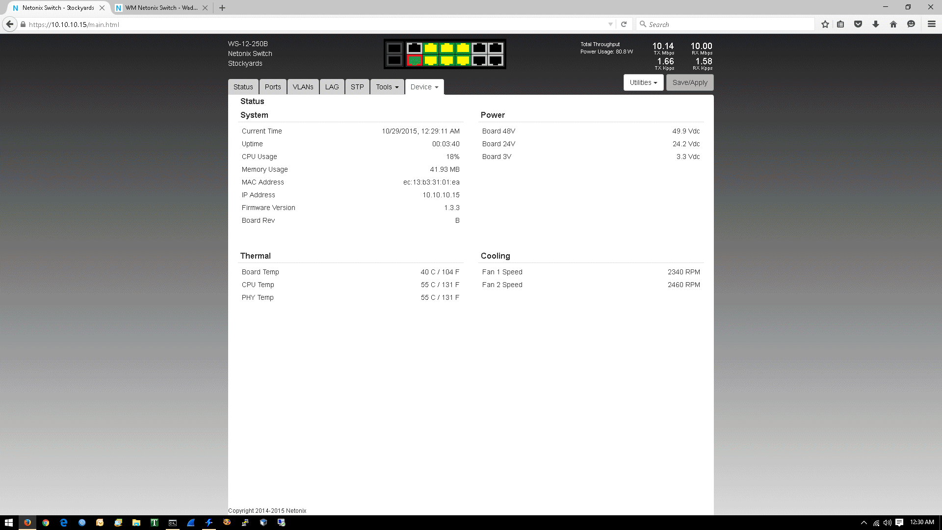

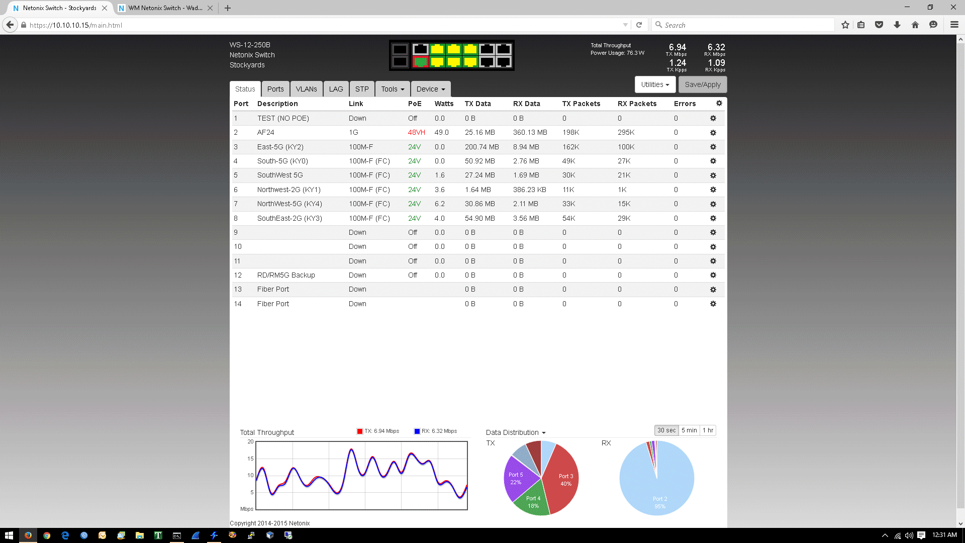

All my WS-8-250-AC units accepted 1.3.6 fine but my WS-12-250B was filling up the log with "voltage should not be zero" on ports 3 & 4 so I downgraded back to 1.3.3. The voltages never did work right on this unit. Should I RMA? See attachments.
