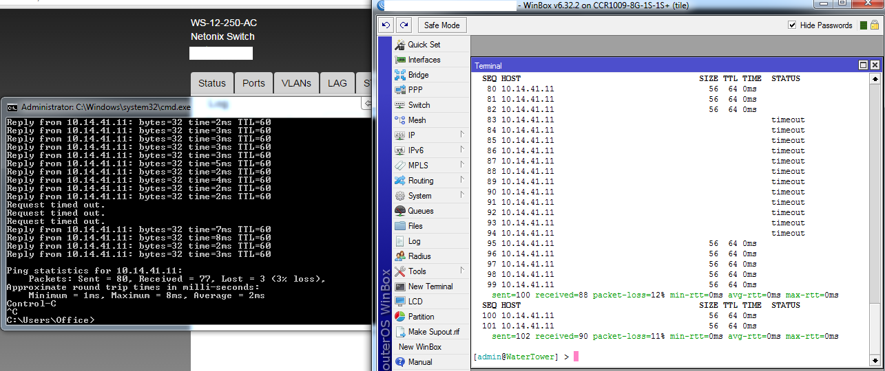

I have a handful of Netonix switches and most of them seem to be just fine. I noticed an issue today on one of my towers, my management software was telling me some users were offline and even the AP's were going in/out.
Their uptime is fine, but i started pinging then and noticed 10pings would go through, then about 30 pings would drop, over and over.
I could ping the AF5x that I connect through, but I had a hell of a time pinging or getting to radios/cpe's downstream of the switch. I finally managed to load the gui long enough to trigger a reboot and it fixed it.
Update: As I type this, it is happening again. It is dropping pings to devices behind the switch.

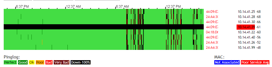

Here is a screenshot of the ping logs from the CPE's from one of the 3 sectors. Green is good, the black marks are all dropped pings.
I loaded 1.3.3 on it just now, we'll see how it goes.

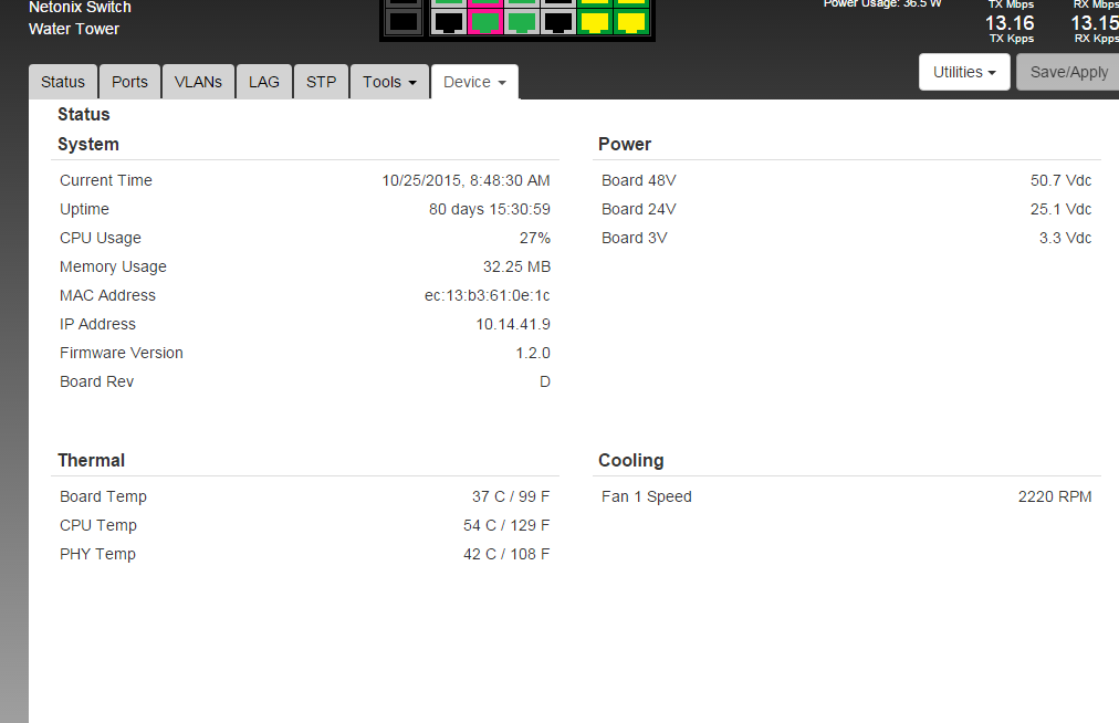

This screenshot is before I rebooted/updated.
The logs just showed ntp client starting over and over, the switch itself lost its route to the internet when I added my new fiber provider so NTP wasn't working. I have that fixed now.
I did skim over the changelogs, nothing caught my eye, I posted figuring if something about my problem sounded familiar with someone I would find an easy fix.
Either way, so far it appears to be ok. I'll report back if it changes. Thanks

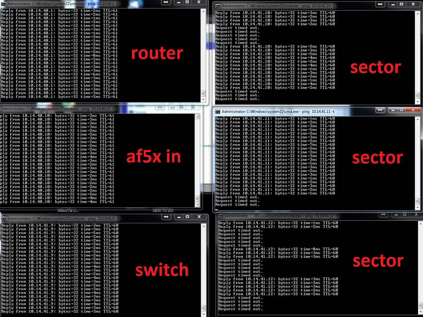

Looks like it is happening again today. Pings both from my office, and even the router right at the tower site are dropping pings.
The 3 sectors are plugged into the Netonix, there is 1 uplink for those 3 sectors to the router. I'm at a loss, looking more into it now.
I'll also say I am not sure it is even the switch that is the problem. Could be anything, just grasping for ideas here. Thanks

Looking further, it appears before the firmware update, the switch itself, and the 3 sectors hanging off it would all drop pings.
But now after the firmware update, (well at least so far), only the sectors are having problems responding to pings, the switch it self is responding to pings just fine.
