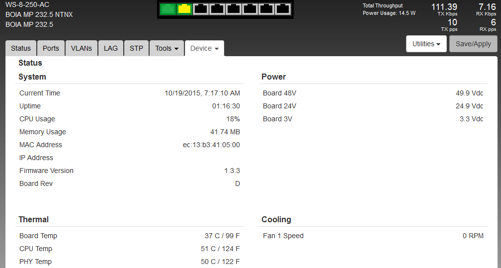

I got an alert this morning that the fan was failing on one of my WS-250-AC units. Researching this, I see where Chris suggested updating the firmware and see if it helps. The switch was running 1.3.2. I updated it to 1.3.3. I now see the fan in this state:
It doesn't stay that way - it will go up to 2500 RPM, fluctuate from 1900 RPM to 2500 RPM, then fall back to 0 for a period of time (a few minutes), then jump to 980 RPM, 2700 RPM, and bounce around.
Is this potentially a firmware issue, or is the fan designed to shut down under certain conditions?

The fan only runs when needed and with a board temp of 37C the fan will be OFF.
If the fan is failing it will report so in the LOG.
We changed the fan to run less in newer firmware.
When we first put out the firmware the fan was set to run more aggressively than needed.
