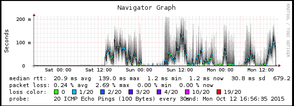

Upgraded to 1.3.3 on a few switches last week. Saturday, it appears, one of my UBNT APs dropped to 10M, which sometimes happens with cabling, etc..not really the issue here.
Since that time it dropped my smokepings to OTHER devices on that same 12 port netonix started going crazy like they were also at 10M even though they were negotiated at 100M(FC). Now these other two devices (SAF Freemiles) are on DIFFERENT MGMT vlans for their pings than the AP and the netonix itself...but they DID share a common customer data VLAN.
I have yet to sit down to reproduce this, but once I forced the AP and Netonix to 100M on both sides, pings to the SAF Freemiles calmed down and have gone back to normal (see attached).
Wondering if something is getting leaked somewhere?
Again, I'll sit down and try and reproduce this. It was just weird that two different devices (each FreeMile is on its own MGMT VLAN) each on a different MGMT vlan and IP network were impacted by this latency.

- Latency to a SAF Freemile
- Screen Shot 2015-10-12 at 4.56.44 PM.png (44.18 KiB) Viewed 8528 times
