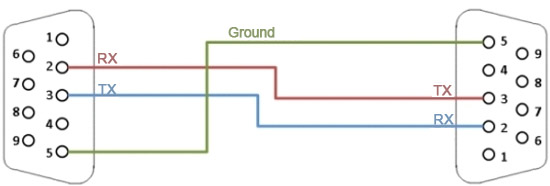

Now you need a console connection to the switch that supports XMODEM file transfers.
In this exercise I am using HyperTerminal Private Edition (HTPE) which you can download here:
http://hyperterminal-private-edition-htpe.en.softonic.com/download
You will need to know the com port of your serial port.
You will also need a NULL Modem Serial Cable.
Once you install HTPE configure it to connect to your switch via the console port with the following settings:
Baud: 115200
Data Bits: 8
Stop Bits: 1
Parity: None
Flow Control: XON/XOFF
Once you configure HTPE and connect to the switch console port you should come to a Linux style prompt of the switch or the boot loader prompt "RedBoot >".

I would make sure your console cable works with another Netonix switch first.
So many people use the wrong cable or software or settings
