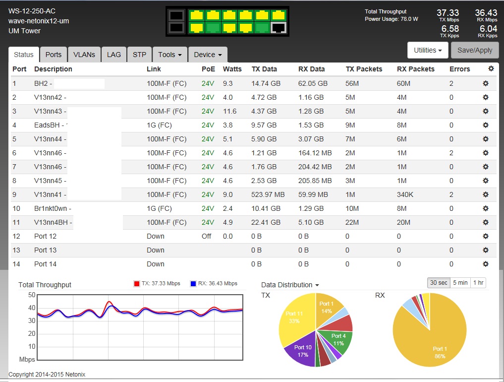

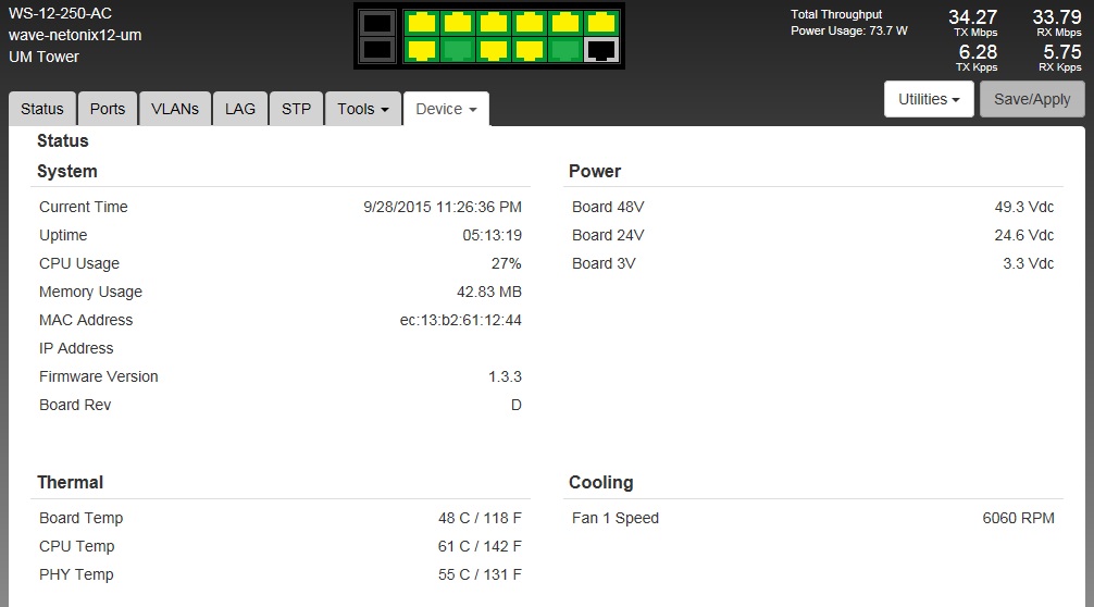

can you do a screen capture of main status tab page, and also of the status page under the device tab?

Please post up a grab of your main Status Tab and the Device/Status Tab.

Everything looks fine on your screen grabs.
Let us know if the units you disabled watch dog on stay up.
It has to be something along those lines.

Sep 29 18:25:45 kernel: link state changed to 'down' on port 1
Sep 29 18:25:46 kernel: link state changed to 'up' on port 6
Sep 29 18:25:46 kernel: link state changed to 'up' on port 7
Sep 29 18:25:46 kernel: link state changed to 'up' on port 8
Sep 29 18:25:46 kernel: link state changed to 'up' on port 3
Sep 29 18:25:47 kernel: link state changed to 'up' on port 1
Sep 29 18:57:27 kernel: link state changed to 'down' on port 5
Sep 29 18:57:27 kernel: link state changed to 'down' on port 7
Sep 29 18:57:27 kernel: link state changed to 'down' on port 8
Sep 29 18:57:27 kernel: link state changed to 'down' on port 11
Sep 29 18:57:27 kernel: link state changed to 'down' on port 3
Sep 29 18:57:27 kernel: link state changed to 'down' on port 4
Sep 29 18:57:29 kernel: link state changed to 'up' on port 11
Sep 29 18:57:30 kernel: link state changed to 'up' on port 4
Sep 29 18:57:30 kernel: link state changed to 'up' on port 3
Sep 29 18:57:30 kernel: link state changed to 'up' on port 5
Sep 29 18:57:30 kernel: link state changed to 'up' on port 1
Sep 29 18:57:30 kernel: link state changed to 'up' on port 8
Sep 29 18:57:30 kernel: link state changed to 'up' on port 7
Sep 29 18:57:34 kernel: link state changed to 'down' on port 4
Sep 29 18:57:36 kernel: link state changed to 'up' on port 4
Sep 29 18:57:50 kernel: link state changed to 'down' on port 11
Sep 29 18:57:51 kernel: link state changed to 'down' on port 1
Sep 29 18:57:51 kernel: link state changed to 'down' on port 7
Sep 29 18:57:51 kernel: link state changed to 'down' on port 8
Sep 29 18:57:51 kernel: link state changed to 'down' on port 3
Sep 29 18:57:52 kernel: link state changed to 'down' on port 4
Re: WS-12-250-AC rebooting all ports
Posted: Wed Sep 30, 2015 8:55 am
They turn red when the units/radios boot because when the radios first start up they connect with a 10 meg link.
You have to have something configured wrong somewhere.
Can I get access to your computer today via Team View so I can look at the switch and the AP's?
Have the browser open to the switch and all the AP's when I connect?
