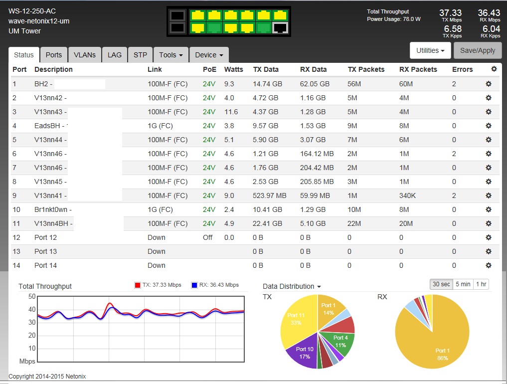

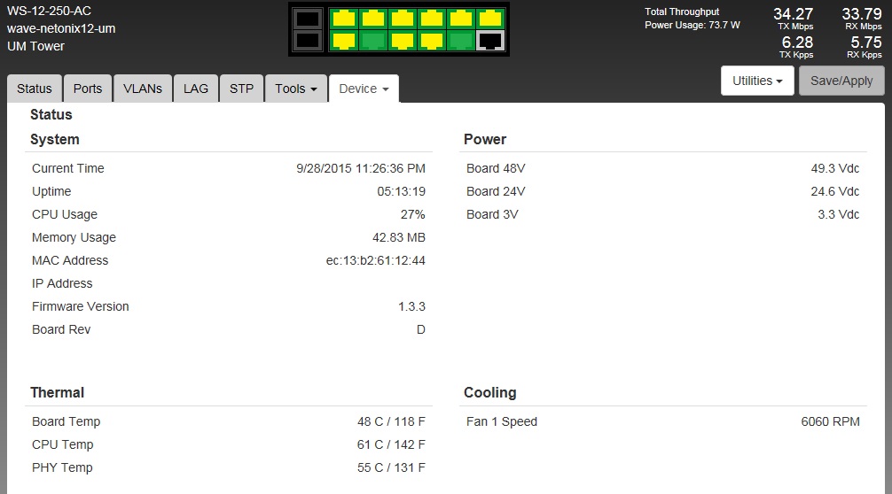

can you do a screen capture of main status tab page, and also of the status page under the device tab?

Please post up a grab of your main Status Tab and the Device/Status Tab.
Please gather some more information, but if this was a problem with the firmware or the switch design you would think hundreds of people would be screaming as there are over 5,000 units now out there including my WISP?

Everything looks fine on your screen grabs.
Let us know if the units you disabled watch dog on stay up.

Re: WS-12-250-AC rebooting all ports
They turn red when the units/radios boot because when the radios first start up they connect with a 10 meg link.
You have to have something configured wrong somewhere.
Can I get access to your computer today via Team View so I can look at the switch and the AP's?
Have the browser open to the switch and all the AP's when I connect?
