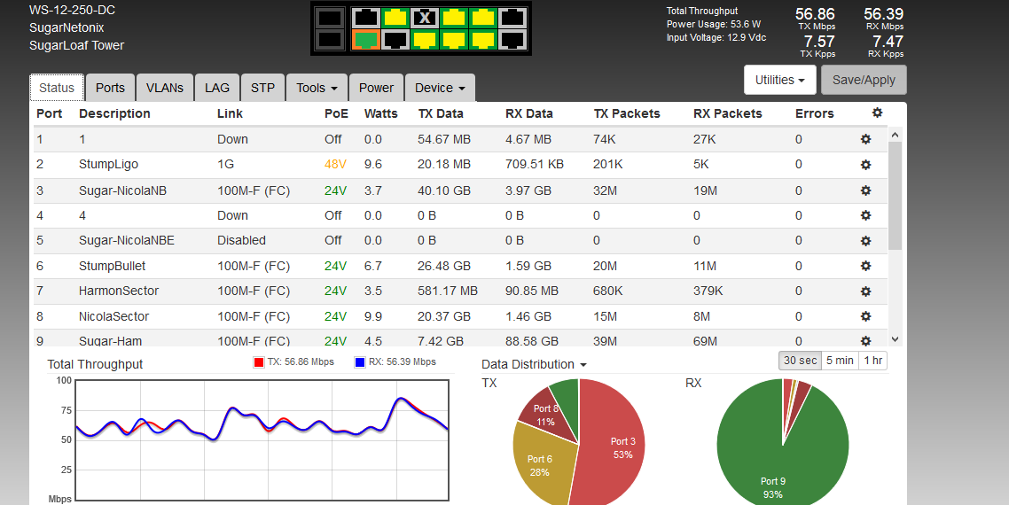

My WS-12-250-DC had an odd event today, it is running 1.3.3 firmware and has been running for a few days with a variety of ubnt 24V devices . Today I enabled a 48V device (LigoPTPUnity) and within a few seconds of that port coming on the entire switch appeared to shut down with no apparent sign of life after several tense seconds I removed its power, upon repowering the switch booted up and ran fine including running the ligo. Power down the Ligo's port and that happens normally, power it up again and down goes the switch. Again I pull the power and repower it and it behaves like all is well ?
Any idea what gives ?

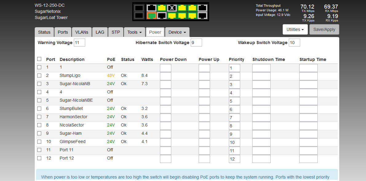

Can you also post or send me some screen captures on your status page & Power page, thanks.

Nope just 48V 0.75 A , plugged in on port #2. current total load including the idle Ligo is 45-55 Watts , 12V battery bank, no settings done on the 'Power' tab

top image is status page ?
Posts: 730
Been thanked: 158 times
Re: DC switch oddity noted
Mon Sep 28, 2015 11:09 pm

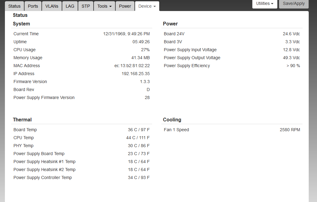

yes, please, i want to see system voltages & heat sink temps, etc, which are on the main status page i believe.
Posts: 730
Mon Sep 28, 2015 11:20 pm
sorry, i mean the status page under the device tab.

ooooooh Device->Status , ok

thanks, everything looks good, so lets make sure i understand what s going on...
