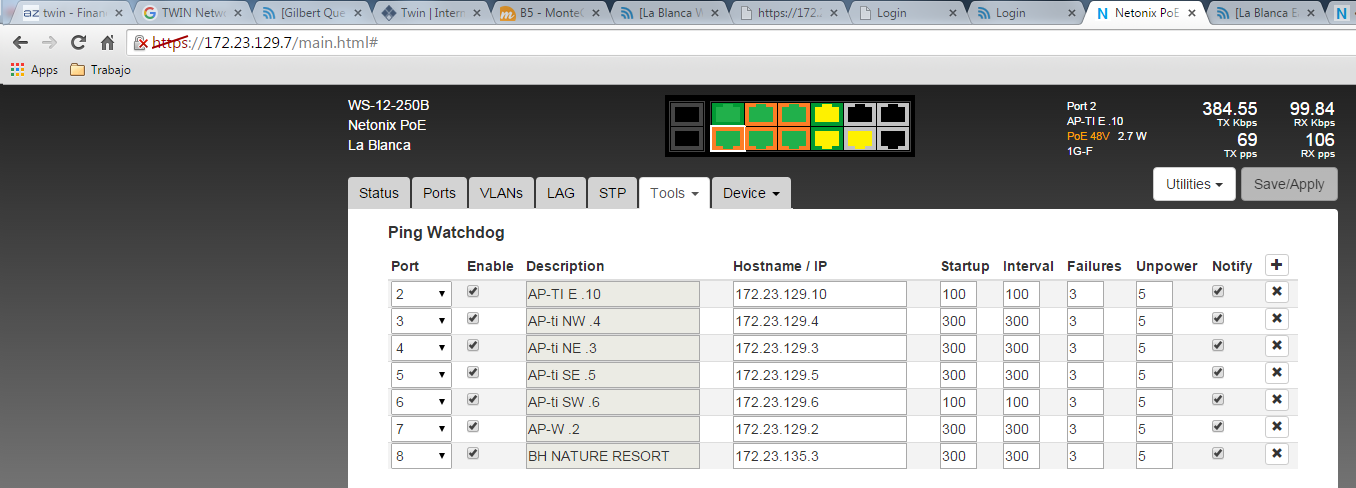

my watchdog is not working
I have set up these settings on the watchdog, please advise if the setting are not properly set up. Thank you
- Attachments
- Screenshot 2015-09-08 15.26.53.png (108.85 KiB) Viewed 22263 times

- gerardor884
Re: my watchdog is not working
1) What version of the firmware are you running? There were recent fixes for watchdog. ***see firmware release notes***
I have the firmware version 1.3.2
2) Please explain what happens? Either nothing or it keeps rebooting your radios?
it does nothing, it does not responds
Please post the VLAN Tab and Device/Config Tab
I am not using VLAN, VLAN is not enable

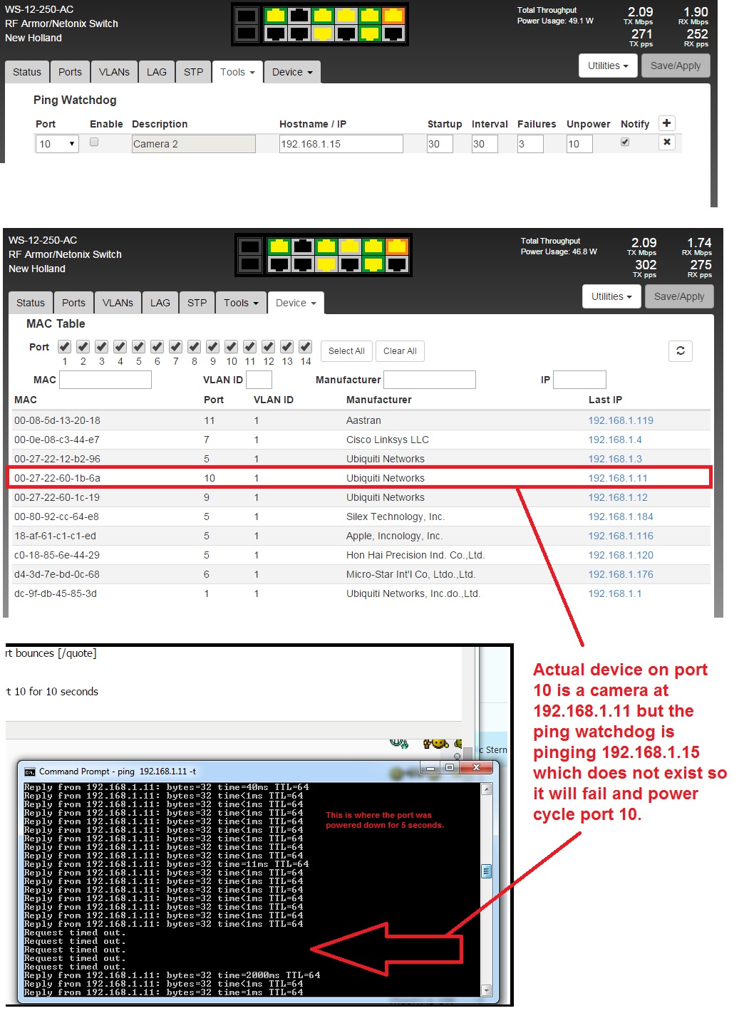

gerardor884 wrote:1) What version of the firmware are you running? There were recent fixes for watchdog. ***see firmware release notes***
What do you mean it does not respond?
It should not respond unless the pings fail 3 consecutive pings in a row and then disable the port POE for 5 seconds rebooting it the device and then send you a an SMPT message provided you have SMTP setup correctly.
I am running a test now to confirm it works, I know I tested this a few weeks ago.
This shows in the log that a ping watchdog was enabled. I have it pinging an address that nothing is at so it will fail.
Sep 8 17:56:18 UI: Configuration changed by 192.168.1.176
Sep 8 17:56:18 UI: PingWatchdog 1 Enable: changed from 'Disabled' to 'Enabled'
Sep 8 17:56:20 pinger: starting up with 1 ping watchdogs and 0 scheduled port bounces
Sure enough it did work and rebooted my camera
Sep 8 17:57:59 pinger: Failure pinging 192.168.1.15, powering off port 10 for 10 seconds
Sep 8 17:57:59 pinger: Cannot notify, SMTP is not enabled
