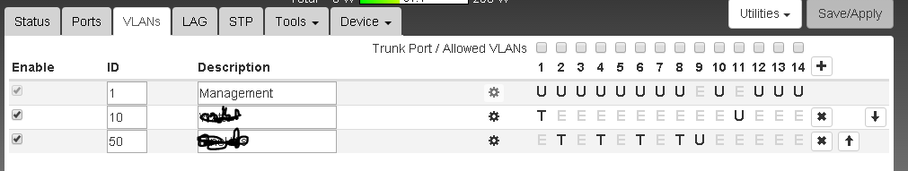

Vlan50, port 9 is 'U'... 2,4,6,8 are 'T', those are hooked up to routers (i'm mid transition, so 2 for old, 2 for new). Port9 is an AF5X.
If I change Port9VLAN50 from U to Q, the router locks me out for the minute countdown... Here's the thing, my PC is in port 3, and my main uplink is on ports 6 and 8, and my other backhauls are on ports 1,5,7 on VLAN1... Port 9 isnt in VLAN1, so why does changing it to 'Q' take down all of the VLAN1 stuff?

Changing U to Q is a drastic change.
A Q port will encapsulate any packet entering it within the VLAN ID tag (in this case 50) and Strip off the outer VLAN Tag when packets leave it leaving either the inner VLAN tag if one exists or an Untagged packet if there is no inner VLAN Tag.
If it worked with U it will not work when you change it to Q unless you make other changes on your network to deal with it.
