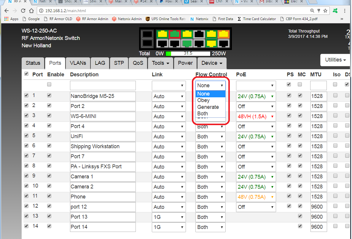

if you do not change the FC dropdown, it isn't applied to every port. Does seem a little weird, though, will discuss with Eric
Re: v1.4.7rcX Bug Reports and Comments
Chris, he's talking about flow control, not PoE. He only used the PoE dropdown to show what a blank option is.
What firmware are you running? I am running v1.4.7rc14
What browser, I am running Chrome.
Firefox 52, I see the same as you and it is not the point of the issue. Read my post again please.
IntL-Daniel wrote:Firefox 52, I see the same as you and it is not the point of the issue. Read my post again please.
Ah - DUH, you are saying there should be a BLANK option in Flow Control (or any drop down when using multi port select) so it does not mess with individual port settings in place????
I say that FC column should be the same as the rest of columns to be sure that if I leave fc column untouched then it does not set "None" to all ports.
I have alerted the "Eric" to your plea and he should address this in the next release
