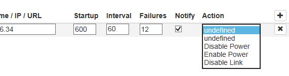

We have a WS-12-DC locked up this morning after upgrading to 1.5.5 Thursday last week. We found both the AF-5X and the Netonix non-responsive. So I wanted to add a Watchdog for the AF which I do not like to use. However I went to do it and found I could not set the watchdog as the choice was not there. I went of some of the other WS I have and look at them and see the choice I wanted to use in them, just not in this one. Should I back the firmware to a previous version and them come forward again?
John
Stephen
Posts: 1077
Has thanked: 105 times
Been thanked: 208 times
Re: v1.5.5 Bug Reports and Comments
Mon Apr 20, 2020 2:48 pm
Most likely cause is you need to default that switch.
Reference:
viewtopic.php?f=17&t=5816&p=31789&hilit=when+you+update#p31789
