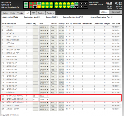

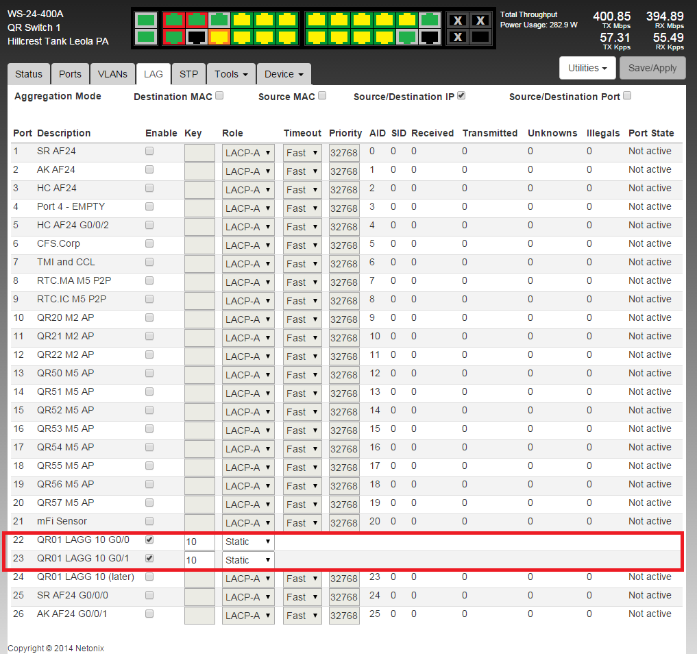

So below I defined a Static LAG, basically the same as LACP as far as VLANs are concerned:

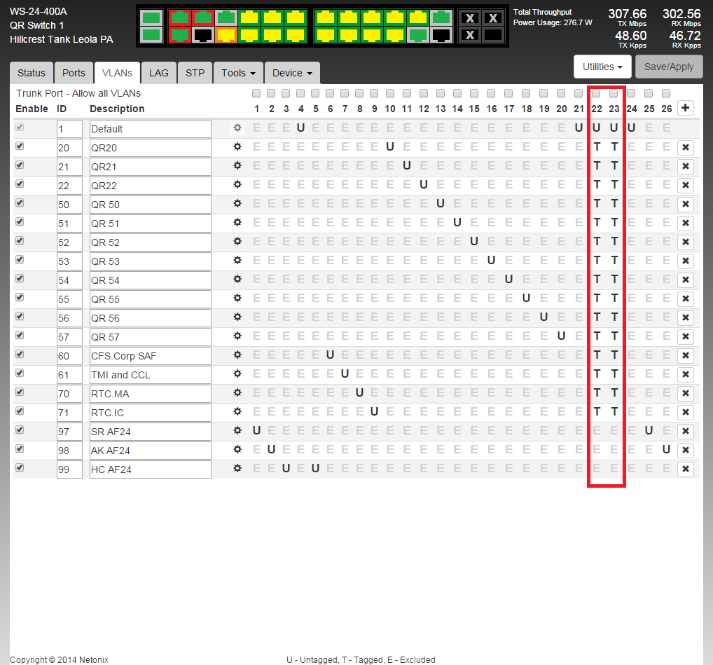

Below is how I handled it on the VLAN TAB, pretty straight forward?

What you wants is for the software to hold the user's hand with a "LOT" of fuzzy logic that would have to go into the interface and then it would limit what people could do in some cases and could create issues.
If someone is creating a LAG they should simply know to duplicate the same values on each interface that is in a LAG on each defined VLAN as shown in the pictures above.
