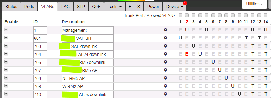

Hi Guys, not sure if reported before and I'm not wading through 8 pages to find out.
Strange issue with one particular VLAN that had me scratching my head. Couldn't get traffic working and so eventually ran discovery and it was showing Port 4 with VLAN 1. When I unticked enable and ran discovery, Port 4 had VLAN 704!!!!!. Then when I ticket enable again it had VLAN 704?
Log file
Nov 4 13:43:54 UI: Configuration changed by admin (XXXXX)
Nov 4 13:43:54 UI: VLAN 704 Enable: changed from 'Enabled' to 'Disabled'
Nov 4 13:45:09 UI: Configuration changed by admin (XXXXX)
Nov 4 13:45:09 UI: VLAN 704 Enable: changed from 'Disabled' to 'Enabled'

Re: v1.4.8rcX Bug reports and comments
Have no idea why, are you running the latest version of firmware?
