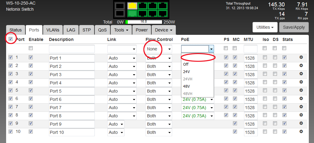

But maybe another bug here on screenshot - in port settings when you select all ports... then there is no "blank" option on FlowControl, so you must always select something, otherwise you switch FC off on all ports.
Re: v1.4.7rcX Bug Reports and Comments
Thu Mar 09, 2017 4:55 pm
Nope, not a bug. You have ports selected that have links and since this is global and affect all selected links it will not let you do anything as we do not let you apply or change POE options on ports that have links for safety reasons.
