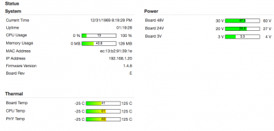

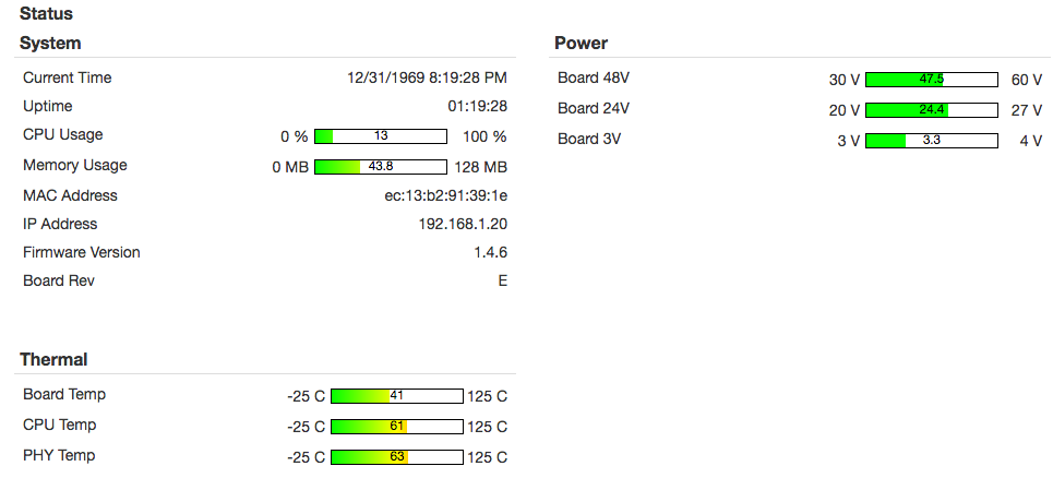

Yes I am assuming and I will ship them back to you on monday. I just loaded 1.4.6 on the one that was rebooting every hour or so before and plugged in 4 ubnt radios. Voltage seems more stable now and it's been about an hour now that it did not reboot:
Will leave it running till monday afternoon and ship it back to you then.
-Gregg

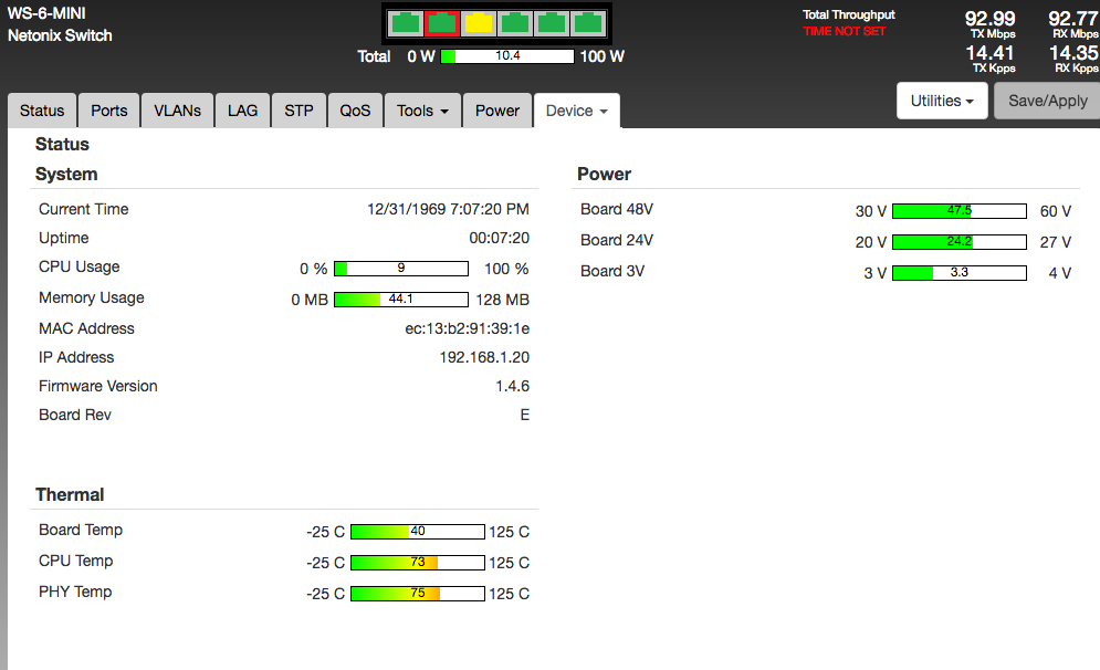

You got it, I have it connected to bunch of devices on my desk now including my PC (and another mini on port 2):
Will report on Monday.
