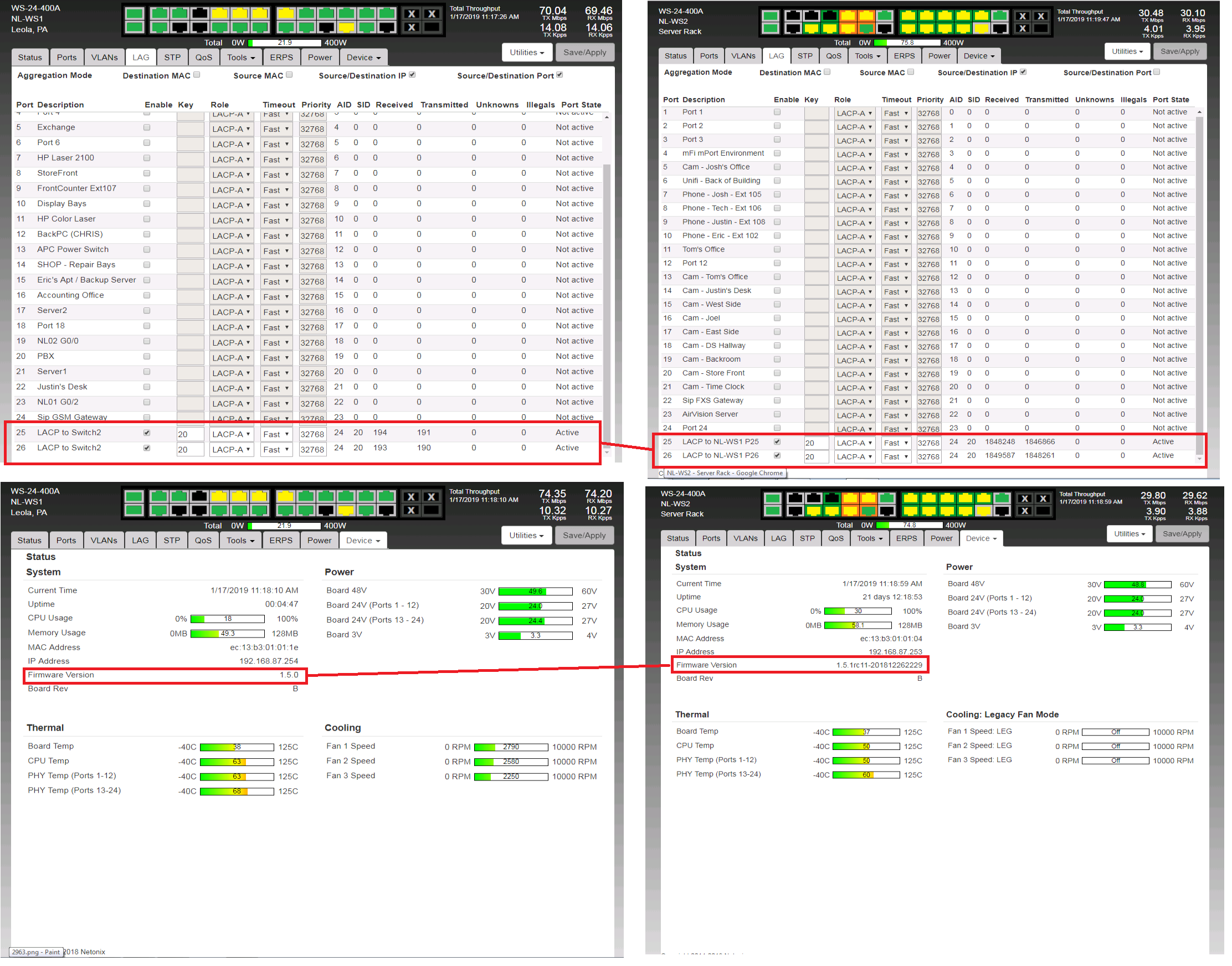

So in the picture below you can see LACP is linked up between 2 switches.
One switch is running v1.5.0 and the other v1.5.1rc11
Now to be fair both were originally v1.5.0 linked up then about 21 days ago I upgraded both to v1.5.1rc11 one at a time as I was doing so remotely and I saw no issues.
They both had been working fine at v1.5.1rc11 for 21 days.
Now today I downgraded NL-WS1 to v1.5.0 and the LACP failed to come up. I then rebooted the switch and it came up. Which was ODD I give you that. I think it was more the fact that the SFP modules I have in these switches act weird from time to time?
I then proceeded to upgrade and downgrade them a couple times with no issues?
Re: v1.5.1rcX Bug Reports and Comments
Thu Jan 17, 2019 1:14 pm
wtm wrote:For what ever reason, when we had 1.5.1 rc in it, and we tried to change "anything" on switch B, it would become inaccesible, and we had to go into the switch A, on the remote end, un-lag our backhauls, then switch B would come back up and be accessible again. Then we could re-establish the lags.
Don't have that problem on 1.5.0
Not sure what changed between the 2 firmwares?
After some further testing I think I am able to recreate this in v1.5.1rc11. Making some obscure change(s) does seem to sometimes (randomly) stop the LACP LAG. If I then disable the ports and re-enable the ports in the LAG it brings the LAG backup.
I need to confirm this does NOT happen in v1.5.0 then go from there.
