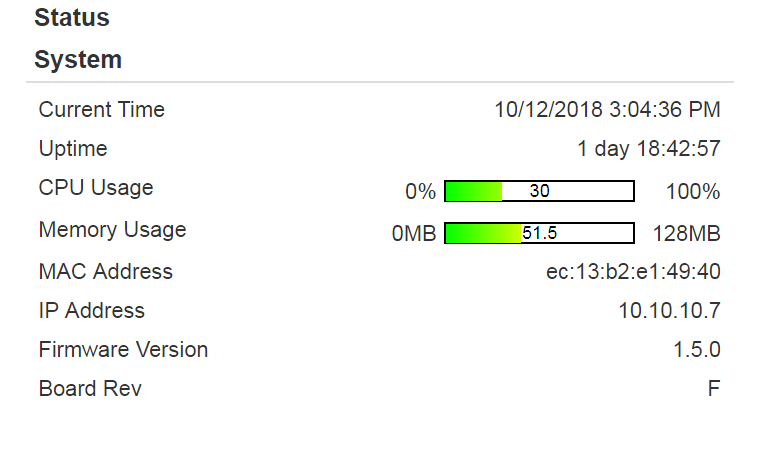

I do see that the only switch I have with more than a couple days uptime also has memory usage that is very high.... Not sure if that's related or not..

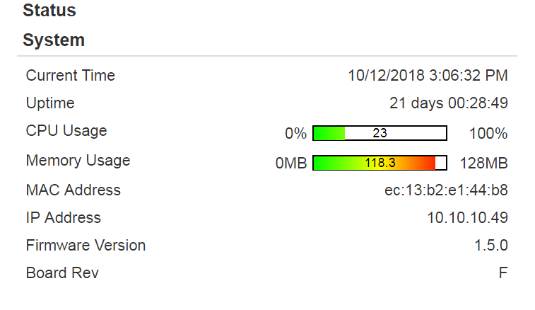

I also have a WS 12 250 dc that keeps cold booting. I've noticed that the memory usage gets really high until there is no free memory about the time it will reboot itself. Any ideas?

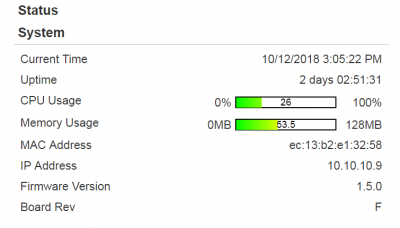

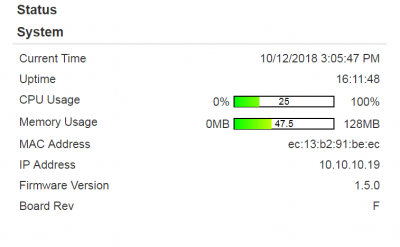

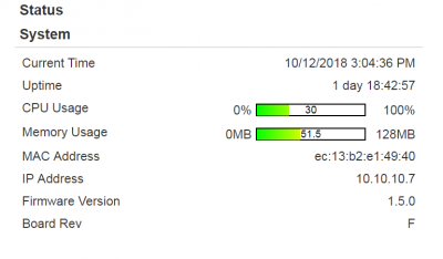

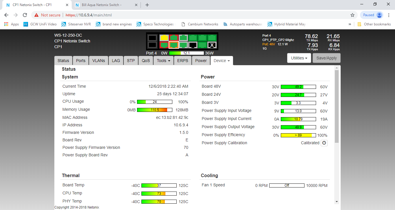

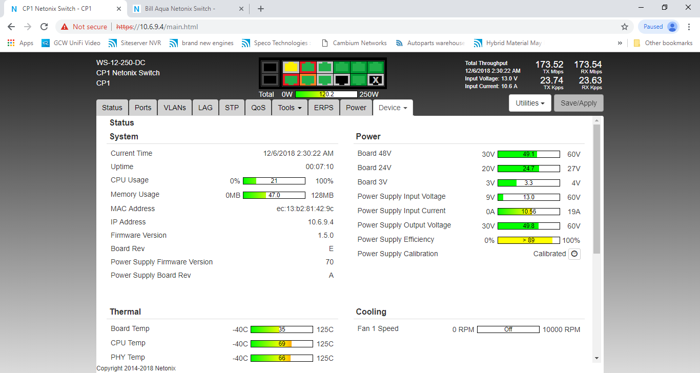

Pics are from the same switch that rebooted itself last month. Seems to happen a few days after i see a memory spike. As a test before i upgrade to 1.5.1rc8 I rebooted the unit to see if memory usage would go back down and hopefully prevent an issue with the upgrade. As you can see the memory usage went down dramatically after just a reboot. Will let u know if i have the same issue running the current FW version.

It is not true. Every my switches with 1.5.0 is rebooted by watchdog because high memory usage. Only few pieces, but other with older firmware is OK.
