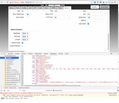

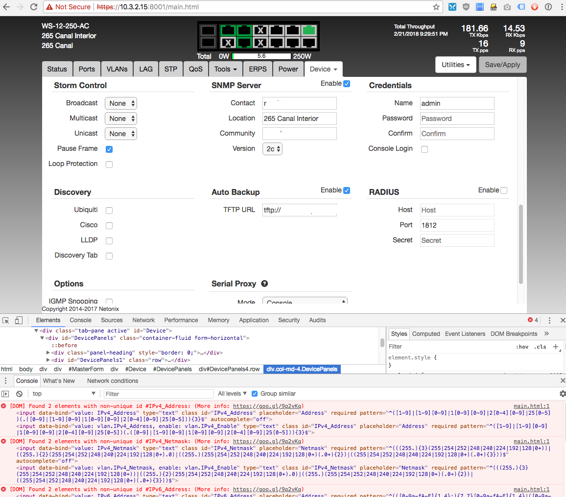

I await the snarky reply about the "obvious" new place this lives, but tried 1.4.9 on a switch that's replacing the "locks up all the time" mini, and I just can't find where to reset the password. This page in general looks a bit slim. What obvious thing am I missing here?

sporkman wrote:I await the snarky reply about the "obvious" new place this lives, but tried 1.4.9 on a switch that's replacing the "locks up all the time" mini, and I just can't find where to reset the password. This page in general looks a bit slim. What obvious thing am I missing here?
Where it lives is below Syslog on the same row as Storm control but on your screenshot there is only white space there. Maybe try a different browser.

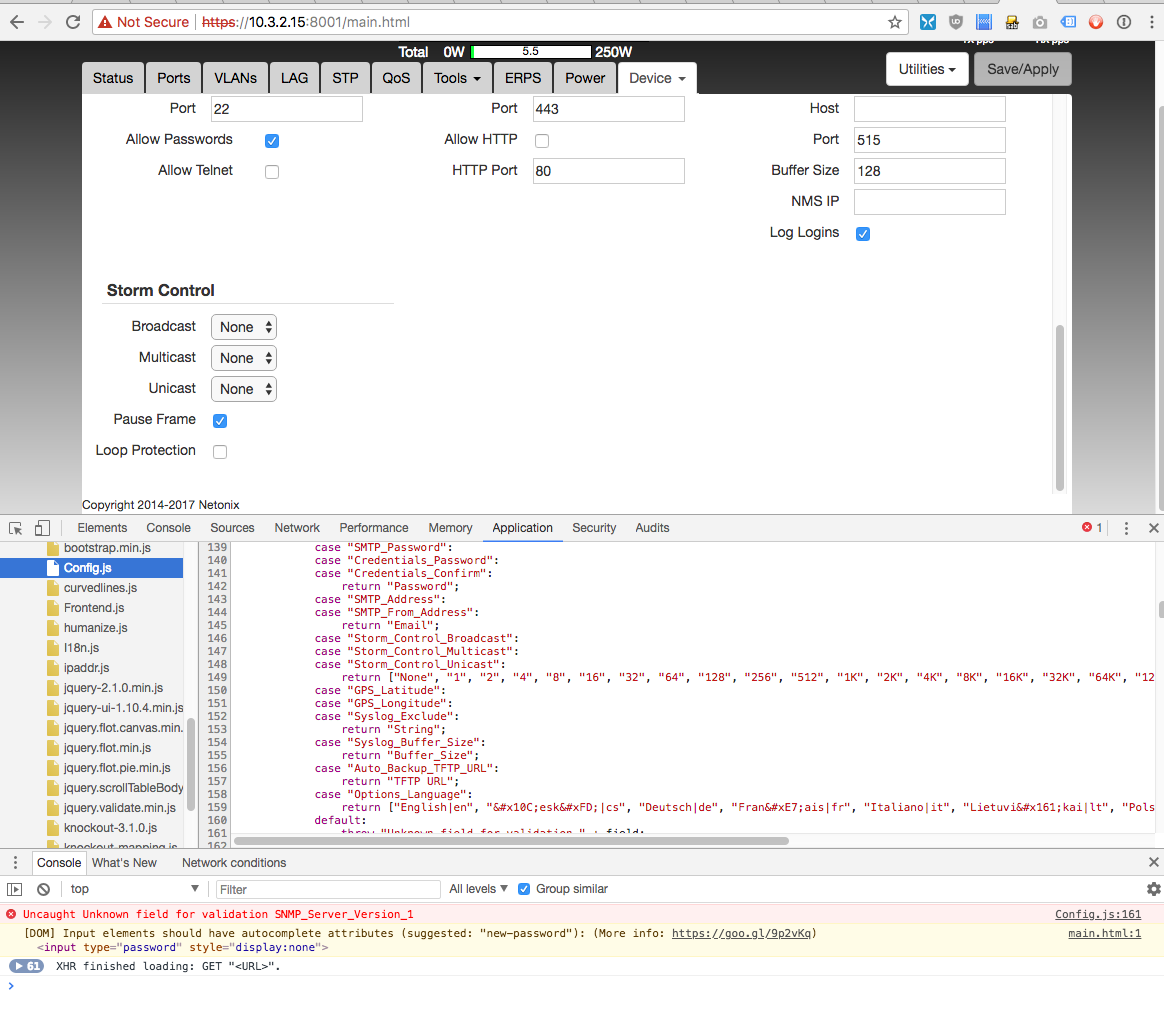

Ah, wow, so now I have to use Firefox. I was reading elsewhere that Chrome was preferred (and that's my default and has been). There's a javascript error here if anyone's interested. No js errors in Firefox (but it does complain about line 6 of the html where page encoding is overridden).

And... going back to 1.4.8 resolves it, so there we are. Different errors, all about id's not being unique (tip: css id = unique as you are probably targeting a specific element for some scripting hook, css class, use all over the place, it's for styling ). Also just note I am running ublock-origin, but it is disabled.

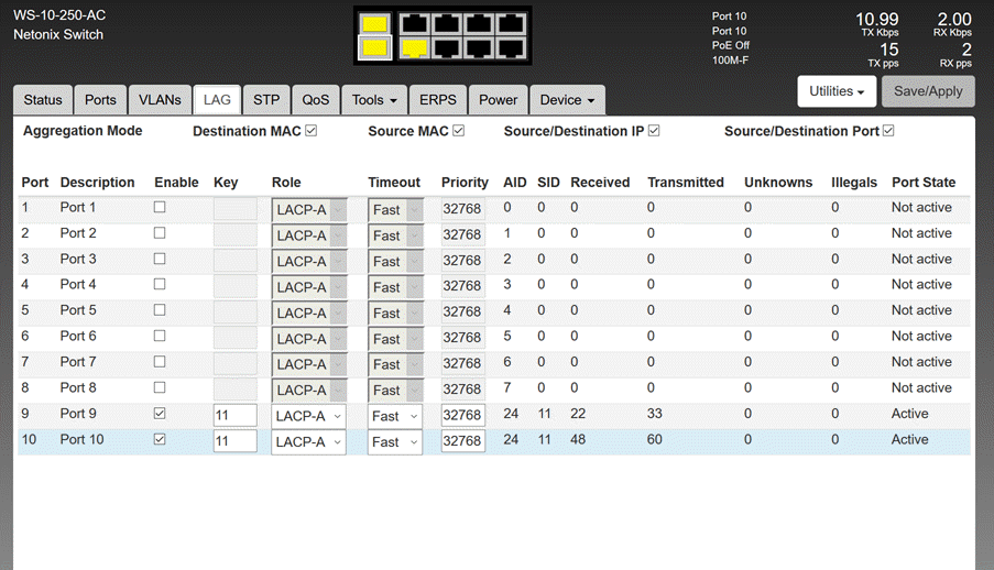

I have a WS-10-250-AC. Just upgraded to 1.4.9. When I create a LAG group (of any type) on the SFP ports, the group does not appear on the VLAN configuration page as it seemingly should.
Here's a screenshot of the LAG configuration page:

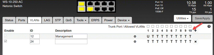

So, based on my search of the forum, when I have a LAG, it should appear on the VLAN page for configuration, right? If so, it's not working as expected:

Re: v1.4.9 Bug reports and Comments
No, why would it?
Maybe review my post here: viewtopic.php?f=30&t=452#p2961
I have a Static LAG at all my towers and you can see my VLAN TAB in the above post, LACP or Static LAG would be treated the same on the VLAN TAB.
