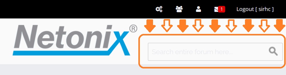

There is this new invention called a "search box"
Read these posts found with a search for "Port Isolation":
