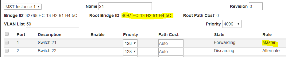

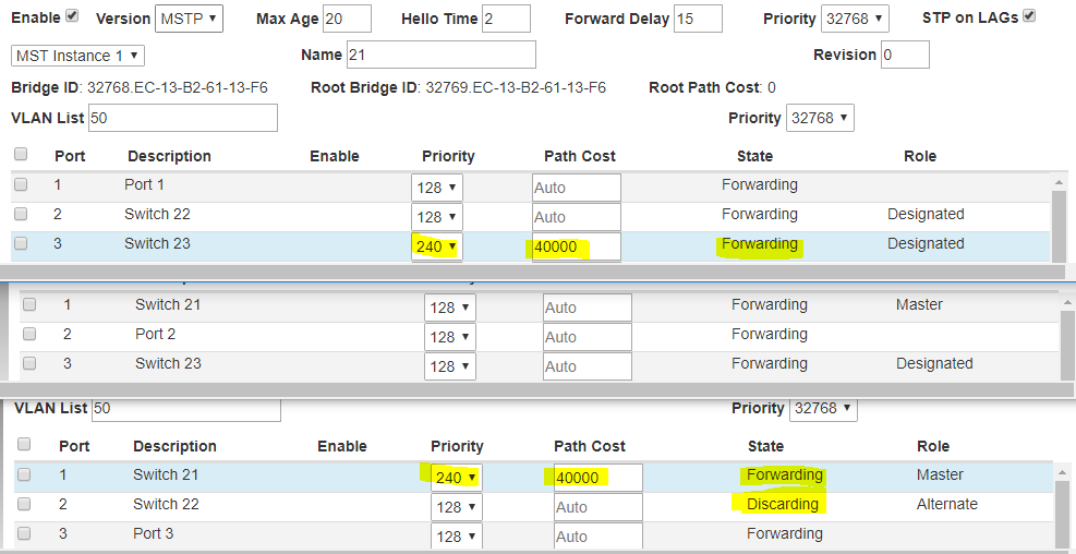

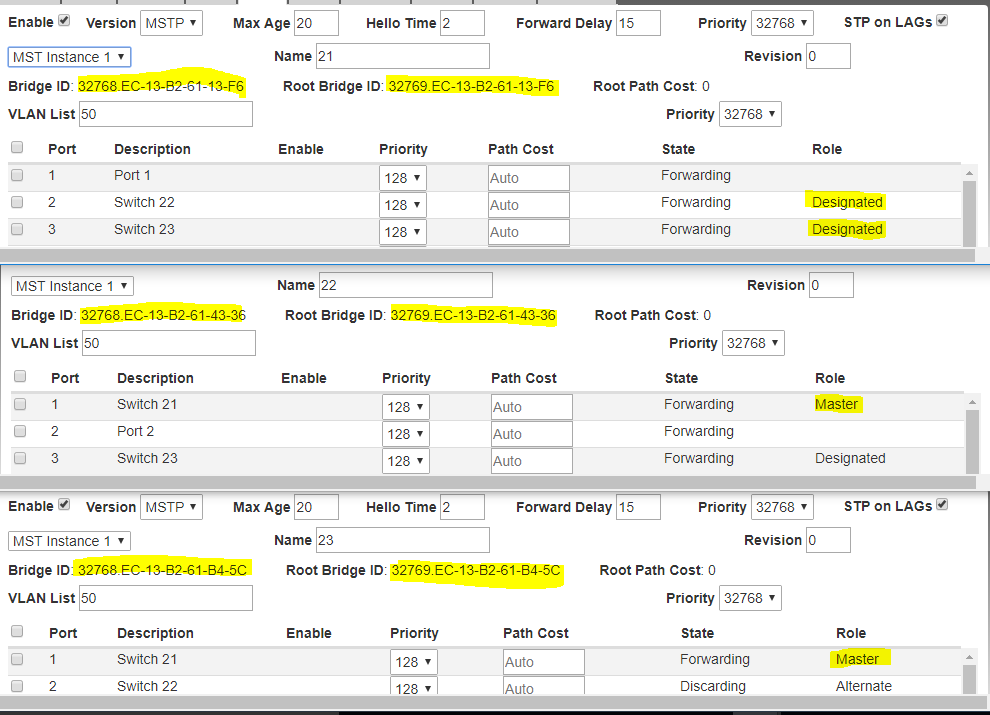

MSTP is still totally broken in RC12. Noting in the instance seem to work.
MSTP instance per port priority just do nothing. The instance root bridge path will be the same as CIST path no matter the value use.
MSTP root bridge priority do only a cosmetic change. It will rewrite the "root id bridge" value on the switch you do the change but won't affect root switch path. On attached image "MSTP instance root bridge id cosmtetic.PNG", you can see with port is use to master path will the switch "root id bridge" is here own "bridge id". Exemple:
MSTP instance "root path cost" always show 0.
MSTP often dispaly their instance bridge ID in the field "root bridge ID" and in the "bridge ID field, display CIST "bridge ID" instead of the instance "bridge ID". It's like the value is writed in the wrong field.

Re: v1.4.8rcX Bug reports and comments
Ok, I digged a little further and it seem to be a region ID problem. The switch beahvior like if region are not matching from one switch to the other.
I try with a HP procurve 2530-24G, a Positron Access Osiris 1024F and a Netonix WS-12-250AC.
If I set same name and revision on the 3 switch, HP and Osiris can see each other on instance and master priority work fine for those 2 while Netonix still see itself as master and port forward follow CIST. Master priority change on the Netonix won't affect the HP and Osiris. If I set different name the 3 switchs, the 3 swtichs behavior just like the WISP switch (see those self as root and follow CIST forwarding).
Tryed back with 3 netonix, make sure it the same name (test), same revision (10), same vlans list (50). CIST behavior fine. Instance see there self as master and follow CIST forwarding.
