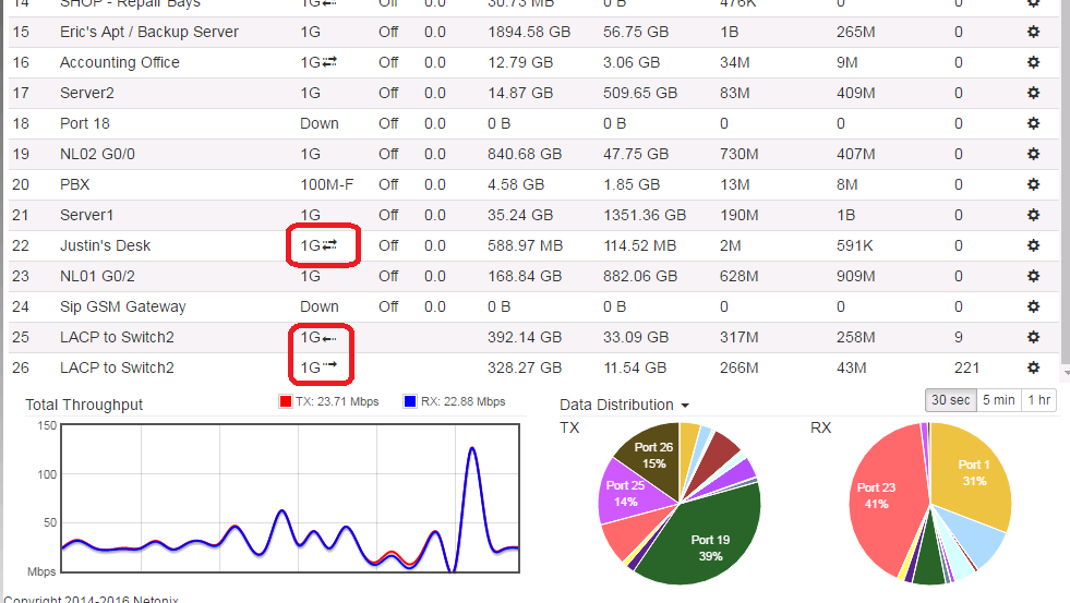

Did you take a look at when selecting generate only in flow control the arrow on status page does not light so it appears to be off?

Mike wrote:Did you take a look at when selecting generate only in flow control the arrow on status page does not light so it appears to be off?
Mike
It is possible that the device the switch is talking to will not negotiate in that mode?
Not all devices support all modes of FC, some just support all or none.

I did already reported this "possible issue", we can see this behaviour on AF24 connected port. I have no idea if it is AF fault or Netonix incompatibility or whatever (the "Obey" option on Netonix works corretly with AF24).

IntL-Daniel wrote:I did already reported this "possible issue", we can see this behaviour on AF24 connected port. I have no idea if it is AF fault or Netonix incompatibility or whatever (the "Obey" option on Netonix works corretly with AF24).
Well you could test this by trying it with another device, if it works on that device but not another then you know the answer.
I just did the test and according to my test we work?
We do not write Flow Control, it is a function of the switch core, all we do is turn it on or off and to which mode such as obey or generate or both.
Since this is a mature switch core used in MILLIONS of switches on the market I would guess that such a simple bug would have been found a long time ago?
Now since you are dealing with an AF radio which you "know" has been struggling with Flow Control issues for several years I would be quicker to suspect the AF based on their track record with Flow Control or at least check another device first before suspecting Netonix which has not been proven to have any issues with Flow Control and in fact follows the industry IEEE 802.3x standard to the Tee?
