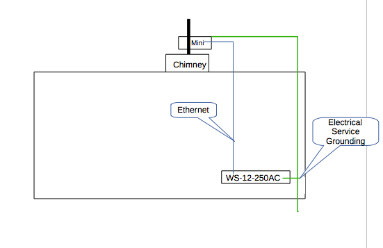

I can say for sure there was no ground potential difference as the only grounding was to the electrical service ground (both mini and the 12port switch in the building). We've measured 0.05 ohms (assuming the ohm meter is ok) between the end of the ground cable on the roof and the grounding copper bar in the building. No other grounding is available on these buildings. Out of 4 identical setups, 2 with FTP ethernet cables seem to be working ok with switch having stable voltage and not freezing and 2 with non-shielded (UTP) cables have had issues and this is why I'm assuming it must have been caused by surges.
Since we cannot replace these ethernet cables (brick building, cables in the wall, not replaceable) what else would you suggest ?
Here's a drawing showing how it's all connected:
-G
-G
Re: WS-6-MINI Keeps crashing/rebooting?
Well if your diagram is to scale and I am sure it is not but if your ground run in green is longer than your Ethernet cable in blue (which is why you normally would put in an Ethernet service loop to insure your Ethernet cable run is longer than your intended ground wire run) then Static or ESD surges would still use your Ethernet cable run to get to Earth ground which would be through your switches.

It's not to scale, ethernet is longer for sure (there's about 6ft service loop at the bottom of the pole) then the grounding cable and the grounding cable is quite thick (14mm2 which is about AWG6) comparing to ethernet. Still I can suspect that ESD might have caused it since the 2 buildings had UTP cables and these are the ones that have issues now hence the question about surge protectors. Ubnt surge protector has discharge lamps that start working at 90V, is this good enough for the mini or do we need something more sensitive ?
