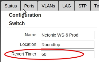

v1.3.9rc8 - Released 12/15/2015
- Fixed UBNT Discovery name
- Ping Watchdog now disabled if port is disabled
- Changing Safe Mode Timer and ability to disable Safe Mode
- Ability to reset counters per port instead of all
- Log file formatting
- UI Enhancement for MAC table
- Add clear stats command to CLI

Chris/Eric is reluctant to go with the test button for whatever reason.
What there is in the latest RC, is the option under Device > Configuration to set a higher value or to disable it completely.
Re: v1.3.8 FINAL bug reports and comments
Thu Jan 21, 2016 12:01 pm
I fail to see the value in the "Test" Button over the way we do it? Please explain the benefit?
You can set the Revert timer to whatever period of time in seconds within reason you want or "0" for Disable.
When you hit Save/Apply if the UI/CLI loses communications with the switch and does not regain it within the defined period of time it reverts to the previous config, if it connects back to the switch in the allotted time it assumes all is good.
