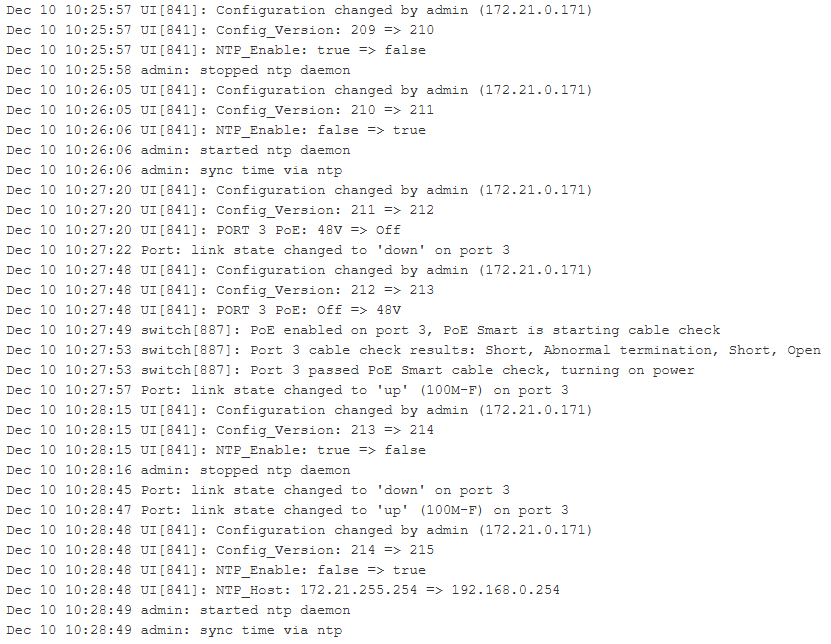

sirhc wrote:
JeffreyS wrote:
KeesH wrote:I noticed two issues.
Some switches - not all - lost the ability to connect to our NTP server. The switch had no problems pinging the NTP server.
Found issue on both WS-6 mini and WS-12-250-DC "Time not set"
I had this on a WS-8-150-AC that I deployed last week running on 1.5.21 and initially after upgrading yesterday morning to 1.5.22 it did the same. Now, the time is in sync.
I had another switch take a bit for the time to sync with the NTP server after boot after upgrading to 1.5.22. I think it may be that I had a time delay set on the uplink device to power up. I since removed this from the uplink devices and the time sync during boot is more reliable. This used to not be the the case from my experience. *shrug*
The old firmware would keep trying indefinitely, which was not a great idea.
We limited it to 10 times. After that it will try every 24 hours.
You can always force it to try and sync by disabling save enabling save NTP
WS-8-150-AC in lab does NTP sync on bootup. Excellent! However, Disable NTP / Save / Enable NTP / Save does not work (see log screenshot). The NTP server time was about 0730 on Dec/11/2024 when I tested this. Note that I even tried changing to a different IP address to see if that would make a difference (same router with multiple addresses). In both cases the switch logs that it did NTP sync but the time didn't change.
ntp not really resyncing
The lab setup uses a MikroTik hEX lite as an NTP server. It doesn't have an RTC so it boots up with the wrong time which the Netonix dutifully syncs to (as it should). Once I correct the time in the MikroTik I either reboot the switch or issue a manual sync from the switch's command prompt.

sakita wrote:...

I modified the time on my lab NTP server and then tried it...
/etc/init.d/ntp restart
stopped process in pidfile '/var/run/ntp' (pid 826)
...time was immediately set to match the NTP server. Cool.
After that I changed the NTP server time and tried the disable NTP/ save / enable NTP save and it did not change the Netonix time.
Again, it does set the time correctly on startup or reboot as long as the NTP server is up and accessible over the network (and it seems to try it enough times to work fine in general). However, when it needs to be done manually, resyncing is currently a command prompt activity (or wait 24 hours).
