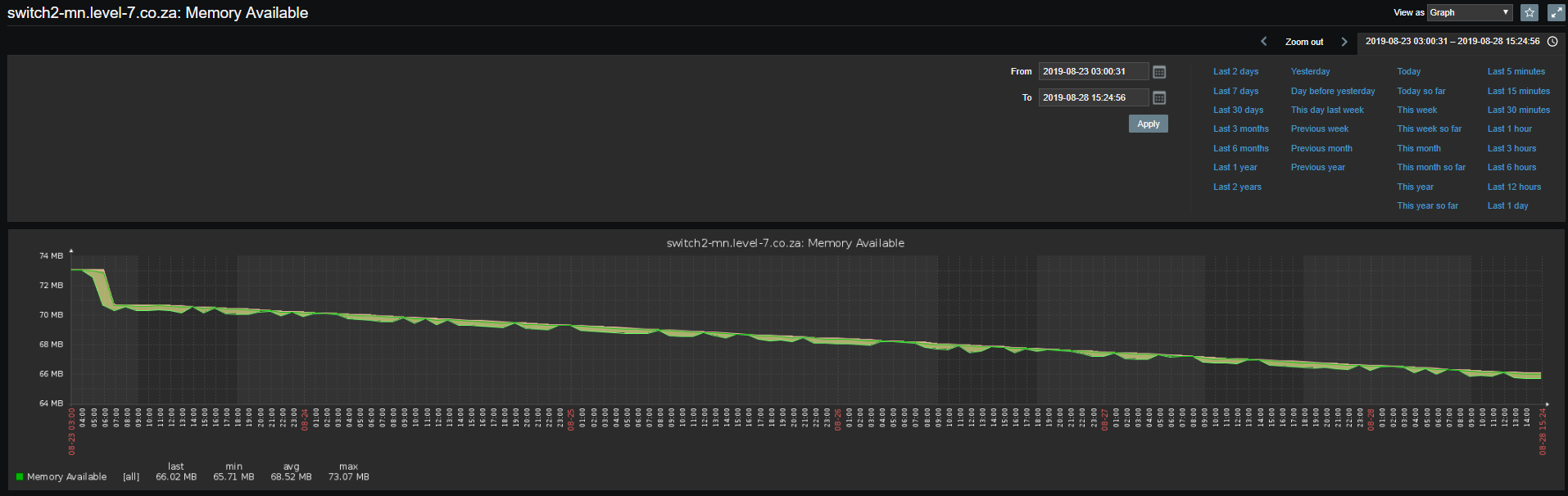

Re: Netonix Keeps Rebooting on 1.5.0
Hi,
We have the same issues, We have now updated to v1.5.4 but it seems like there is still Memory being used/lost day by day.
Please see graph attached when available memory reaches 0MB the switch reboots.
[img]C:\Users\User\Desktop\Netonix%20Mem%20usage.PNG[/img]
- Posts: 1080
- Been thanked: 210 times
We've been trying to track this one down for awhile. I have a few questions that will help us isolate it for your situation. Do you have any SFP module's inserted? Are you using Discovery at all? Do you use SNMP in anyway? Did you notice a difference in the rate of memory loss when upgrading to 1.5.4?
I have SFP modules. Discovery is off. I use SNMP.
