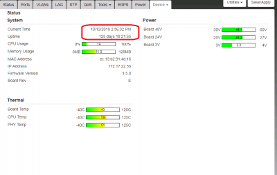

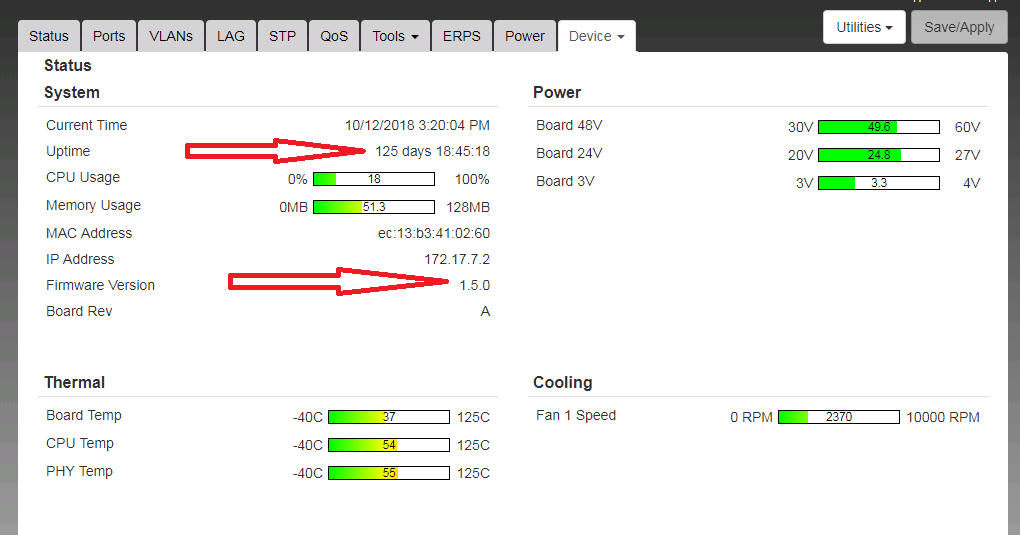

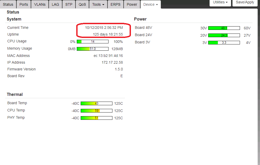

we encountered the same issue on all 5 switches. logs below.

Re: Random Reboots - 1.5.0
jpaine619 wrote:I'm seeing random reboots on _all_ of my switches on 1.5.0. They've been upgraded at various times over the last month and a half. (Always with a reboot first). But switches that saw huge uptimes on 1.4.9 are now rebooting before hitting 30 days uptime. The only switches I have that aren't rebooting (cold) randomly are the couple I still have on 1.4.9
Anyone else seeing this? I highly doubt it's hardware related, because most of these switches are pretty new.. Less than 2 years old at the oldest, and some are less than 6 months old.
Also, once the switch reboots, it works just fine, but it's killing POE to all the ports.
I am at a loss as I am not seeing this at all?
I run a WISP as well and I simply am not seeing it?
Re: v1.5.0 Bug reports and Comments
Went through all my towers and they are all up as long as they should be, here is another one.
