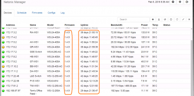

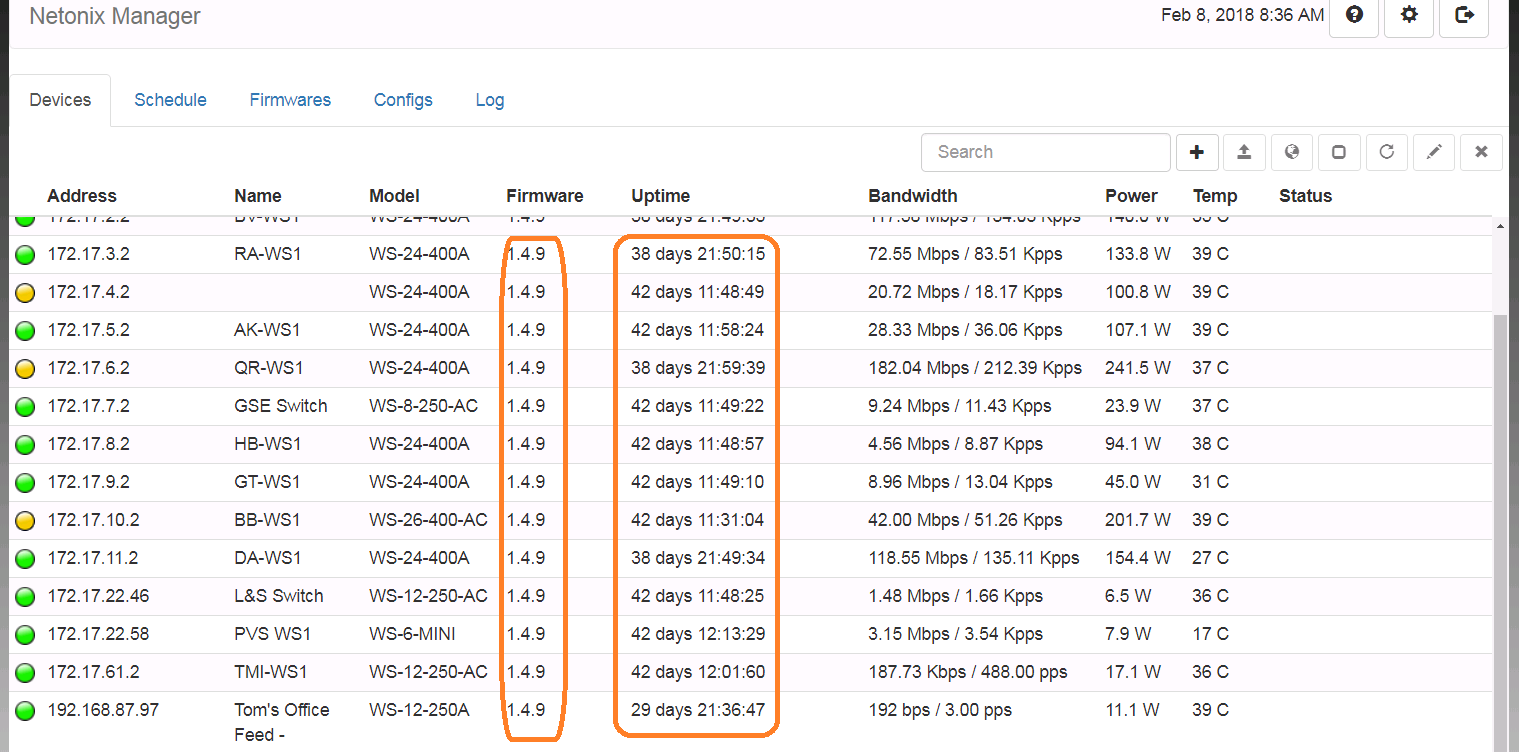

<sigh> 3rd lockup in a month on 1.4.9. And the second time I've had to recover with the paperclip method. I had a switch lock up AGAIN today, drove to the tower, cut the power to the switch, counted to 30, powered the switch back up. ...... NOTHING.
Switch was totally unresponsive. So, I cut the power again, stuck in the paperclip, etc.. etc.. etc.
Then spent the next half hour re-configuring it.
Never had a lockup on 1.4.8, nor any of the rc releases leading up to it.
Something is wrong with 1.4.9
Re: v1.4.9 Bug reports and Comments
jpaine619 wrote:<sigh> 3rd lockup in a month on 1.4.9. And the second time I've had to recover with the paperclip method. I had a switch lock up AGAIN today, drove to the tower, cut the power to the switch, counted to 30, powered the switch back up. ...... NOTHING.
I am running v1.4.9 on all my switches no lock up. If there was something wrong like this you would think a LOT of people would be reporting this.
Go ahead and downgrade to v1.4.8, my guess is issues will remain.
I would love to investigate this but simply saying I have a "lock up" does not help especially when I do not see this.
My "guess" is something else has changed on your network? Maybe you upgraded to newer airMAX AC radios or airFIBER radios and your seeing a Flow Control Packet lock or something?
Nothing that I can think of changed between v1.4.8 and v1.4.9 to cause this.

Maybe you could do some testing to help.
Did you attempt to connect with a console cable before defaulting or rebooting to see whats up?
WHat model switches was this?
Need a lot more info to even begin to help.
