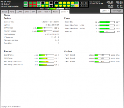

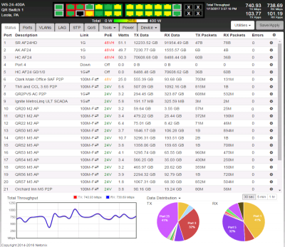

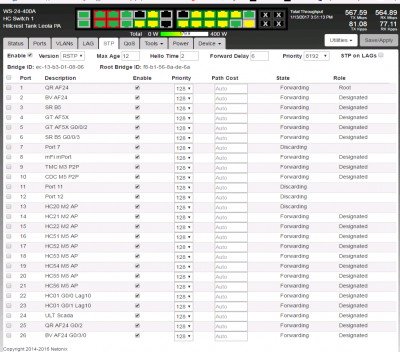

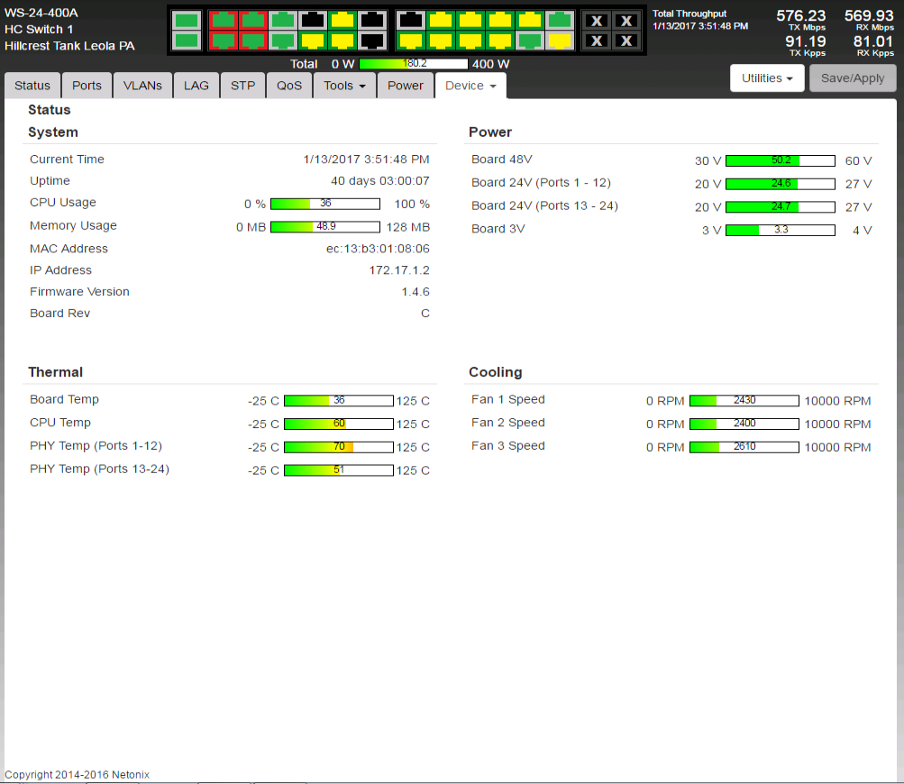

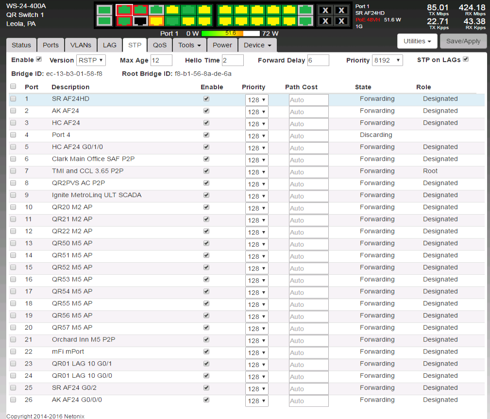

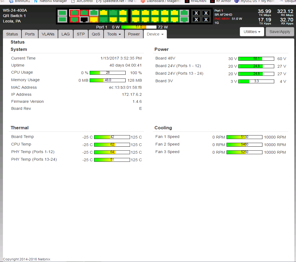

Re: v1.4.6 Bug reports and Comments

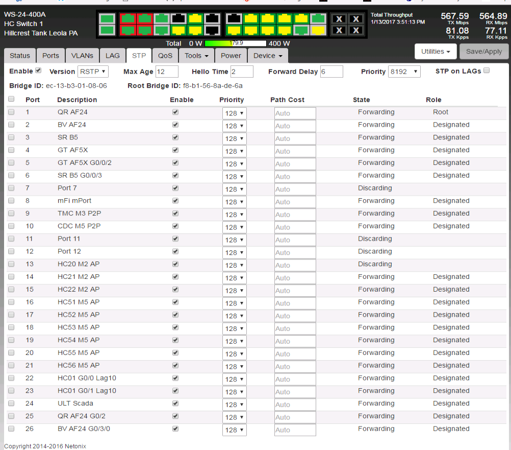

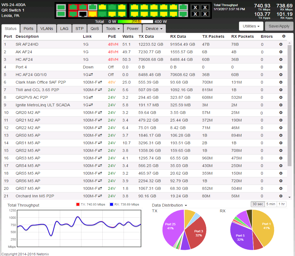

Well all I can say is I have 20+ WISP Switches in service and they all have RSTP active as well as Loop Protection and I have absolutely no issue at all with STP???
Below are 2 of my my largest/heaviest loaded switches, no flapping routes?????
Now I do run a large routed network so one switch does not feed another switch directly as there is a router at every tower???
However in my offices I have 2 or more WISP Switches hooked together and I have no flapping ports in any of my offices???
At Netlinx we have (2) WS-24-400A and (1) WS-12-250A with no issue.
At RF Armor / Netonix we have a WS-12-250-AC and several other switches we use to test firmware and serve the office and no flapping ports?
Also if you have another switch in the mix like a ToughSWITCH which does have RSTP broken who knows???
Maybe try enabling RSTP on 1 port at a time until you find the issue? Might take days to discover the port or ports that lead you to the issue?

sirhc wrote:Well all I can say is I have 20+ WISP Switches in service and they all have RSTP active as well as Loop Protection and I have absolutely no issue at all with STP???
