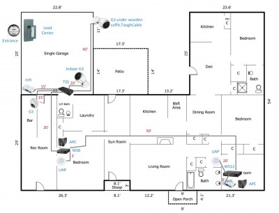

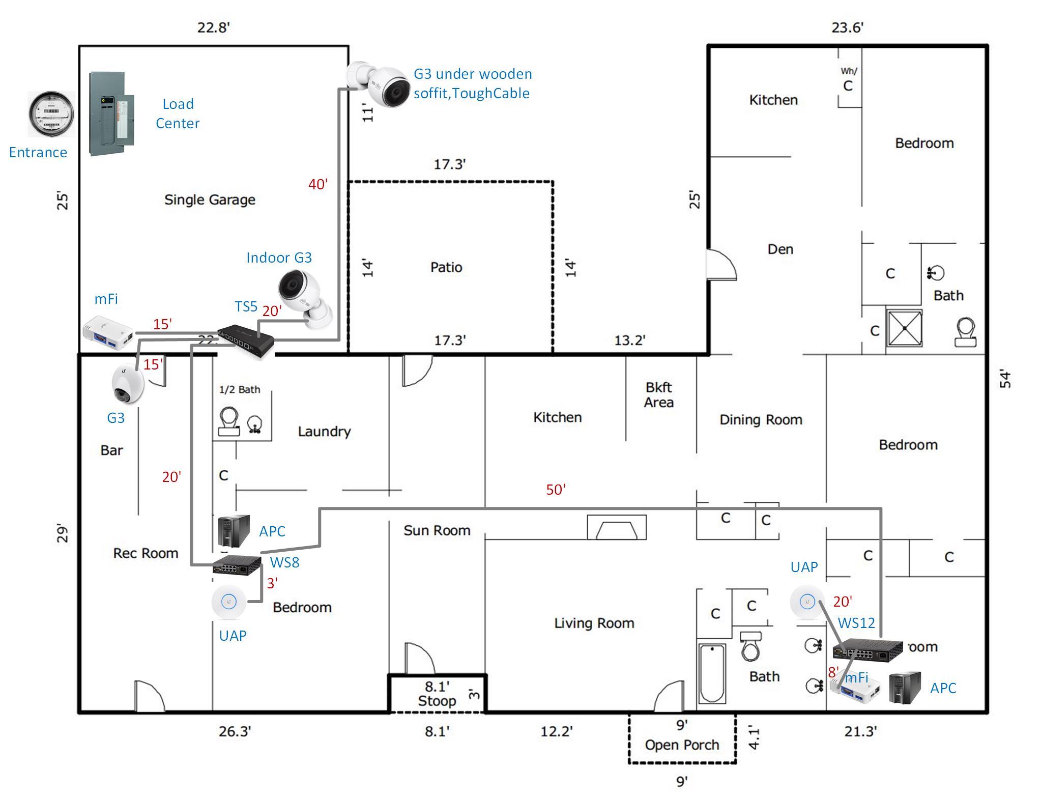

First, thank you very much for taking the time to look at this.
Hopefully the drawing attached is a bit better.
As you can see I'm no artist !
It is very possible there is a ground issue.
Have worked in data centers for decades and although I'm no electrical engineer am familiar with them... just didn't expect to see one in this type of setting.
If there is, I just have to work around it and try to avoid them at all costs for other installs I do.
This experience will lay the ground work for future setups and the price is better paid now than later.
You are correct the one you have now wasn't sure protected, totally my fault.
Everything is now.
There are no sub-panels, and if you have any questions on the picture let me know.
EDIT: That main ethernet trunk may be closer to 75' now that I think about.
Thanks again for your time - hopefully this is something simple.... but I rarely get those :roll:
Re: Power out of range? (3V)
Sun Aug 21, 2016 1:07 pm
OK this drawing is AWESOME - Thanks
The only possible ground issues could be that the Electric service ground rods need attention or another ground rod added which is easy to do. If your ground rod or rods are not good then there is no place for surge protectors to shunt excess current to and this excess current is trapped within your electric service. For WISPs this is often seen when they encounter radios at customer houses with blown Ethernet ports but the radio portion still works fine.
Please examine your electric service ground rods and ground wire connection in your panel to insure they are SOLID in the ground and connections are free of corrosion and tight.
You may also wish to consider adding an additional new ground rod about 4 feet away from existing rod or rods and bond them to the old ground rods with #6 copper and 2 acorn connectors.
At my house 17 years ago when I first got into being a WISP I had a poor ground rod and often lost radios here every time it rained. Once I added a new ground rod the problem went away and I have never lost any additional equipment since then. You can get a ground rod, 2 Acorns, and some #6 copper wire at Lowes or Home Depot.
Tomorrow I will send you back your WS-8-150-AC you RMA'd
I would like to take that TS5 out of the picture for a couple reasons but mainly because the TS5 is powered by a barrel connector and has no access to Earth Ground.
Once you get the WS-8-150-AC returned do you have enough switches to have all switches Netonix? If not you could purchase another one and I will ship it to you with the repaired RMA unit and if in the end we can not solve this issue I will take it back as a return.
But please check your ground rods and please consider adding a new ground rod before we replace the existing switches.

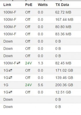

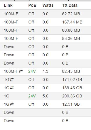

Did notice there is no Watts column on the main status page of the WS-8-150-AC like there is on the WS-12-250-AC/
Is this architectural differences ?
WS8 is running 1.4.3rc6 and WS12 is running 1.4.2
WS8
WS12
