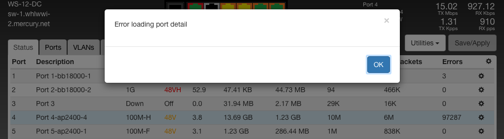

I have a port that is showing errors. When I tried to look at the "Port Detail" to find our what kind of error is being generated, I get an error that the port detail cannot be displayed. There is no error in the switch or linux log.

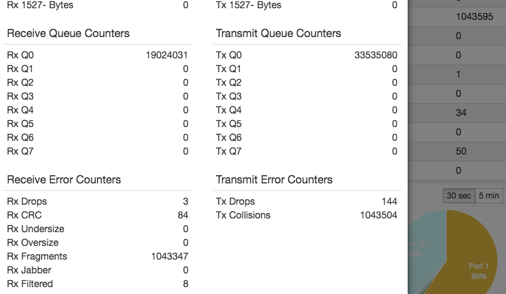

Issue with "error loading port detail" seems to be some sort of loss of session or authentication issue. A colleague was able to open it (using Chrome). I was on Safari. After logging in again, I am able to view it. I should note that I normally use Safari and have never had an issue looking at port detail in the past so this is not a persistent browser issue with Safari.
Next issue:
In the background (status tab, greyed area on right), it shows 1043595 errors on this port.
In the foreground (port detail), it shows 2087090 errors (cumulative total of all errors, both transmit and receive).
I'm guessing that the "errors" we are seeing are "Tx Collisions", as we have temporarily forced the device on this port to 100-H as there seems to be a cable problem.
My questions and comments are:
1. If there are a total of 2087090 errors on the port, shouldn't the status tab report 2087090 errors and not 1043595?
2. It seems as though Rx Fragments and Tx Collisions are incrementing at almost the exact same rate, as though there is a bug causing a single value behind the scenes to be reported as both on the web page.
3. Tx Collisions are a normal operating condition of CSMA/CD Ethernet networks. I don't think they should be counted as an error on the status page, and I think it is a little confusing to put them in the Error Counters section. If it were my decision, I'd probably move it to the Total section on top. That said, Excessive Collisions (frames dropped due to congestion) and Late Collisions (typically caused by duplex mismatch) are errors that should be counted and reported in the Error Counters section, but I don't see them there. Is the Tx Collisions reporting Excessive Collisions or Late Collisions and perhaps not labelled clearly?
Thanks!
